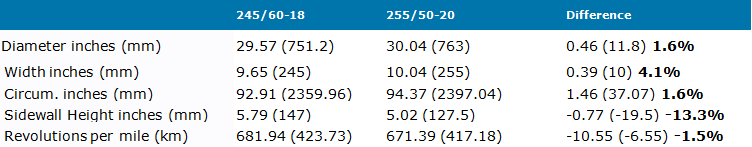

GC is a 5 pass vehicle. The 5 pass Explorer equivalent is the Police Interceptor Utility which comes with a full size spare (18", inside). I haven't tried, but it may be possible to fit an equivalent 20" spare in the PIU (assuming the dimensions of the 20" spare are the same as the 18" - which they should be pretty close).
The size difference is so small, it should fit fine. It doesn't seem like it would take much additional metal to make a full size fit in the retail Explorer, with the 3rd row.
