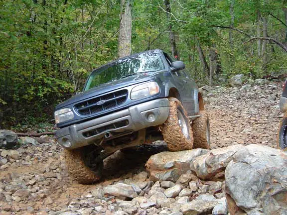

as far as the hidden.. you couldn't really see it except for the little tip sticking out. before i put the body lift on it fit perfectly in the openings of the bumper. after the body lift i had to basically shove the bumper plastic over it which you can kind of see in this pic. i made a little license plate holder that fit in the hitch that kept it from being noticeable except when i was on the trails.
and normal with the license plate because i forgot to remove it for that trip...
