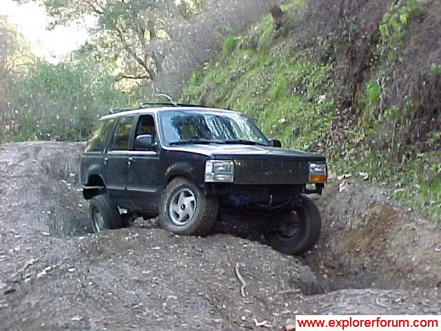

And yes, I do drive a beast:
Dead Link Removed
Alec, where did you purchase your rims/tires from? How much did they run ya? I still don't understand why you say you don't need your front wheels, just because it's SC'd doesn't mean you don't need 2 of your 4 wheels, LOL
mo... he needs all 4, but doesnt need his fronts when wheeling... they dont have any power to them anyways.... however, the rears of all explorers flex like mad... the leafs and disconnecting the sways leave a lot of travel....
i have yet to see an ifs have a pic like this... i know, ttb doesnt have that much travel, but for stock, it has a lot more than the torsion setup
