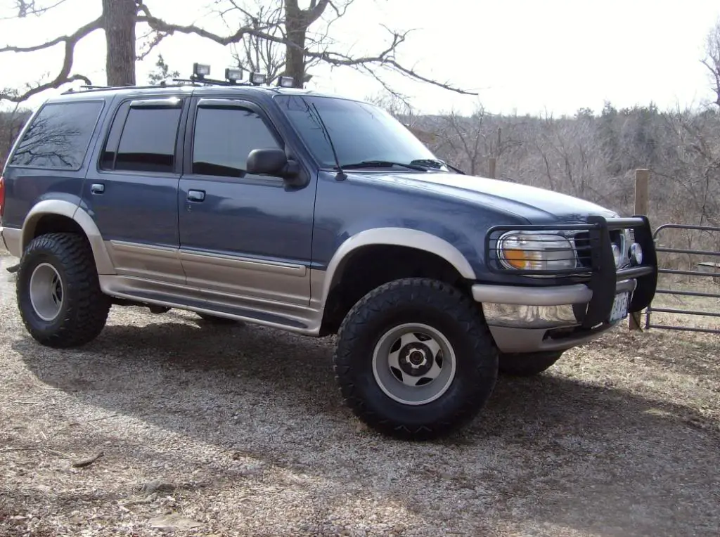

Howdy... I recently finished lifting my X and got 33x12.50s under her. I used some wheels that I had laying around but they had the 5 on 5.5 bolt patten. I got some 1 1/4 in wide adapters to work with the stock lugs. Has anyone had experience with adapters... does it cause a significant strain on the spindles/ drive components? or no more so than the normal lifting stresses? Thanks in advance.
the vehicle:

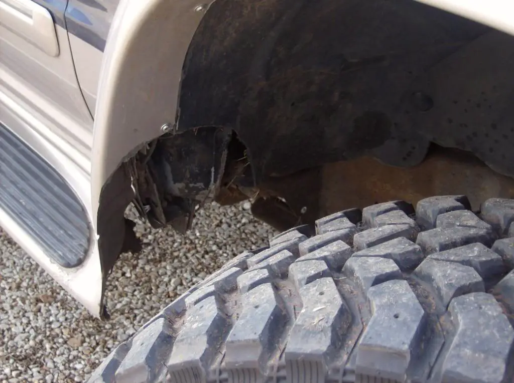

the "trimming" required:
I can't believe i missed that article. Thanks. I guess I'll just keep an eye on it. Yeah, the trucks great in the mud and snow. Now I can't call into work due to weather though.
First off, nice looking truck!
