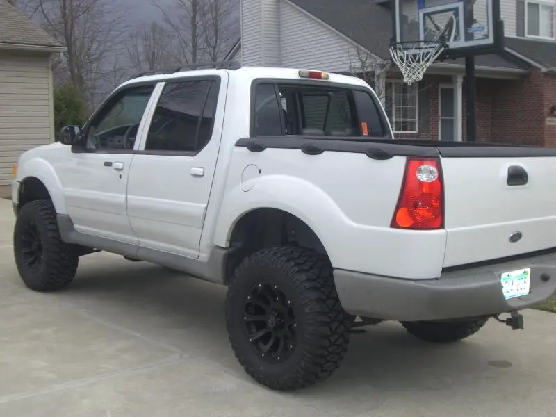

As a few have said 4" seems to be the sweet spot for ST. I have a 4.5 BS with a 17 X 9 with a 33 X 12.5 X 17 Tire. I really couldn't be happier.

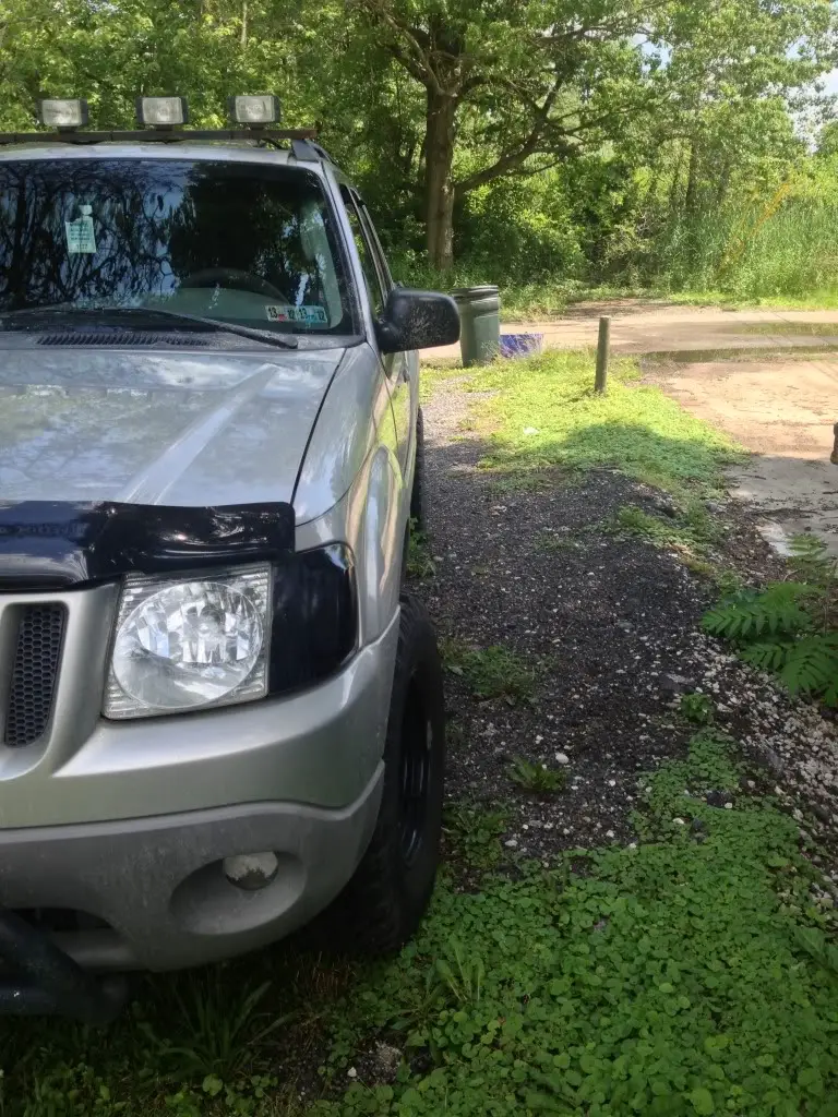

My Trac with 31x10.5x15 and 2"TT
