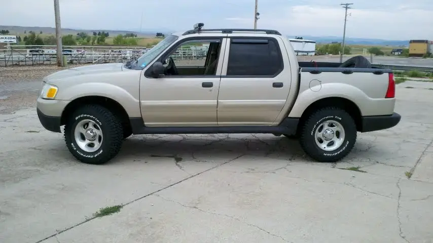

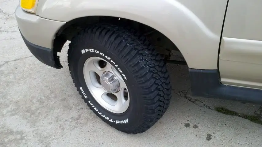

i personally have 265/75R16 on my truck with 2" in front and 1.75" in the rear and love how they fill the wells
Thanks for the pics and thoughts. I was originally leaning toward the 265 75's. but I started second guessing if wider was better. good info. Would Spacers help on the aggressive look or would it cause more rubbing?
yes specially if you run 265/75R16 on factory rims the tires are tucked in pretty tight on mine and dont rub but a 1" spacer would help tons and most run between 1-1.5" on the tracs.
EDIT: currently my 265/75R16 = 32.2" by 10.6" if your a little worried on that you could downsize to the 265/70R16 = 31" by 10.6" those would fit with absolutely no problems
