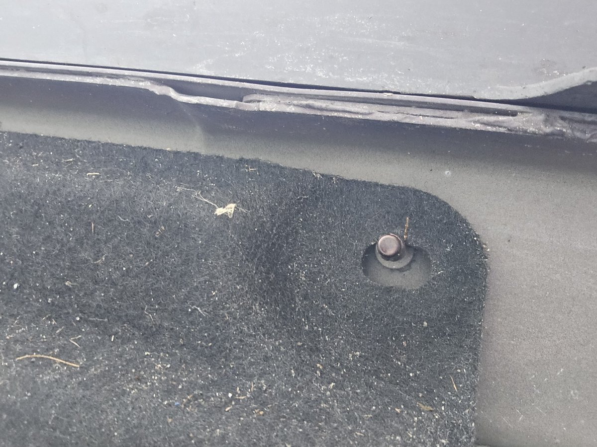

Here's a couple of pictures. One shows the fastener, and the other shows the bare stud. They just push on to the stud. They fasten the panels underneath the truck

i have seen where people replaced those with a M6 nut and fender washer. Seems to be a common cause of a rattle from the underside of the vehicle.
Absolutely do not replace those undershield fasterners with the same part!!! It's been responsible for all the ticking, flapping, tapping noises people have on the highway. They will inevitably fail. Use a fender washer and M6 nut in stainless steel. Replace all of them under the car... I think 8 of them?
I was missing one & only noticed because I saw that the undertray was sagging.
Coincidentally, a server rack nut was the right size & being in IT, we had a ton. Zipped one on there & it's working great. And was free.
Thanks for all the replies. Happy to see the forum is active. The M6 nut and fender washer fix sounds promising. Thanks again.

Similar to this, it's the M6 nut used for racking a server to the rack. These snap into the rack
Man ,I am glad I read this. I've been having that rattling on the highway.. sounded like it was in the B pillar or rear passenger door. Checked under each today and was missing 2, the panel was flopping around.
Went out and got the fender washers and m6 nuts.. all tight and finally quiet on the highway.
