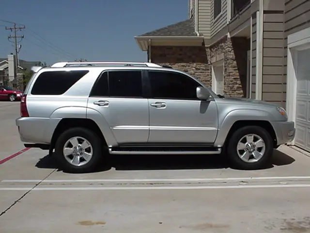

Yes its true, and I think im going to end up getting one of these. Unless someone else has a suggestion about another vehicle that is around the same price or cheaper. I think this will be my best bet based on power, features and reliability.
OK,
I give up, What is it???? Whatever it is it looks damn sweet!! ;)
Looks like a Yota 4 Runner.
