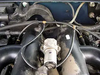

To the gurus on this on this forum, im a newbe and i was wondering wheres the IAC on a 2000 sport with a sohc is located? Does anyones have any pics?
take the plastic cover that says "SOHC" off the top of the engine, the IAC is right under that. on the top middle of the upper intake.
here is a picture of the IAC on the SOHC engine with the plastic cover removed.

Hahaha you guys are the best,much apreciated,Thanks Manaen ..........
