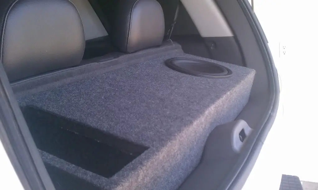

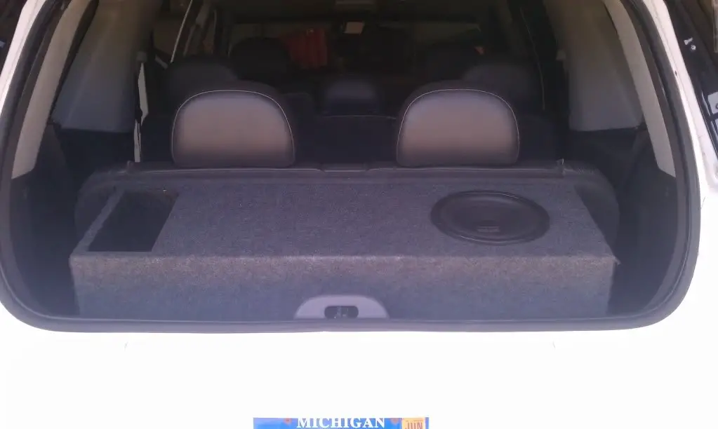

Here are pics for reference:
Looks good! I put my amp under the 2nd row seat because I have 2 12's that won't fit behind the third row haha
LOL 2 12's is too much for me! I just really wanted a little more bass. I have Kicker 6x8's in all the doors and an nice Kenwood Headunit. Just a simple little system is all.

Looks good man. I have my amp under the storage compartment that runs behind the third row. I used the bolt that secures the seatbelt buckles for the third row as a ground. I can still close the storage compartment flat(with the jack removed) for when I need to take my sub out and not mess with removing the amp too.
Heres my 8" behind the third row

What are the dimensions on that box?
I've been dying to install my 10" Alpine TypeE but none of the boxes I already have even come close to fitting behind the 3rd row.
