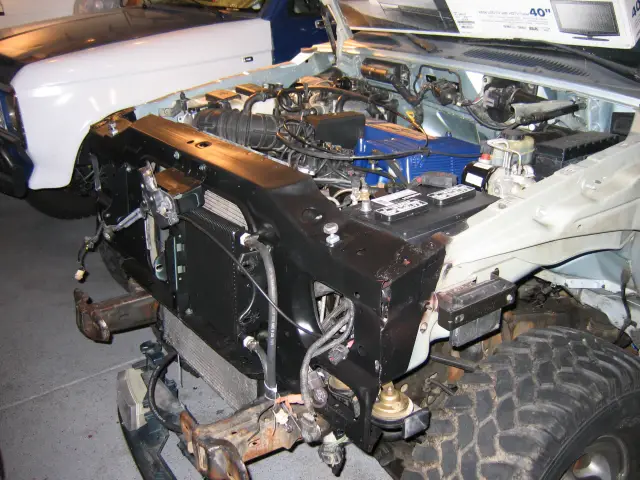

The horn has quit working. I can hear the relay when I push on the steering wheel. Now I am trying to trouble shoot this thing but I cannot locate the darn horn itself?
It's a 97 Ex
Thanks for any clues.
On my '99 its below the battery tray.
bottom right corner of pic is the horn sticking out, just like Aldive said
Is it that brass colored object?
yes there are two of them, the horns are hooked up with a single blue wire then they get their ground from the chasis, I would look at the steering wheel button and wiring before I looked at the horn itself, you can do a quick check to ensure the single wire to the horn(s) has not come loose..
