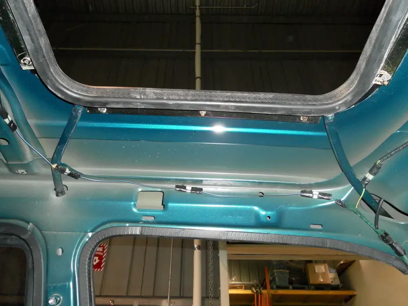

Here's when I had mine apart

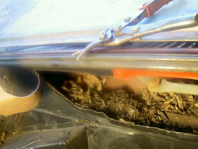

To change the air dynamics of the engine compartment and to add a snorkel, I removed the section of firewall that blocks the windshield mechanism so I can work on those arm. The snorkel is about to turn into engine compartment.
The other reason was to let the engine compartment breath thus a cooler running engine via the louvers below window.
Check out all the crap i found when I removed the sheet metal that previously blocked this area. This is on the pass side. Ford should have had an access door.
Talk about potential rust problem with all that wet crap in there.
And here is probably the only pic of what's behind that metal bulkhead.
Here is what was under all that crap, the fresh air vent that went to the heater box inside cab. Note how it's raised above the floor. Easy to see how water can get in there when it was all blocked.
But check out the water opening just to the left of the raised vent. This was blocked by all that crap. Might be able to clean from outside if fender/door is not in way.
On the driver side was a mouse nest lol.
