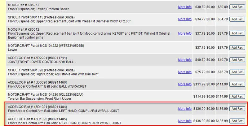

Sorry to bump the thread but RockAuto do not have the Moog upper control arm anymore. Would the AC Delco would do as well?
The above mentions Moog part number K8708T & K8710T, anyone know if this is the correct part number?
Do a part number search for those Moog numbers at Rock Auto. They probably have them at one of the warehouses. I've seen that before.
Remember, Rock Auto doesn't stock a single part. They are brokers...not a parts house.
Why would you consider AC Delco when you could get the Motorcraft for a similar price? I'm just curious is all.
