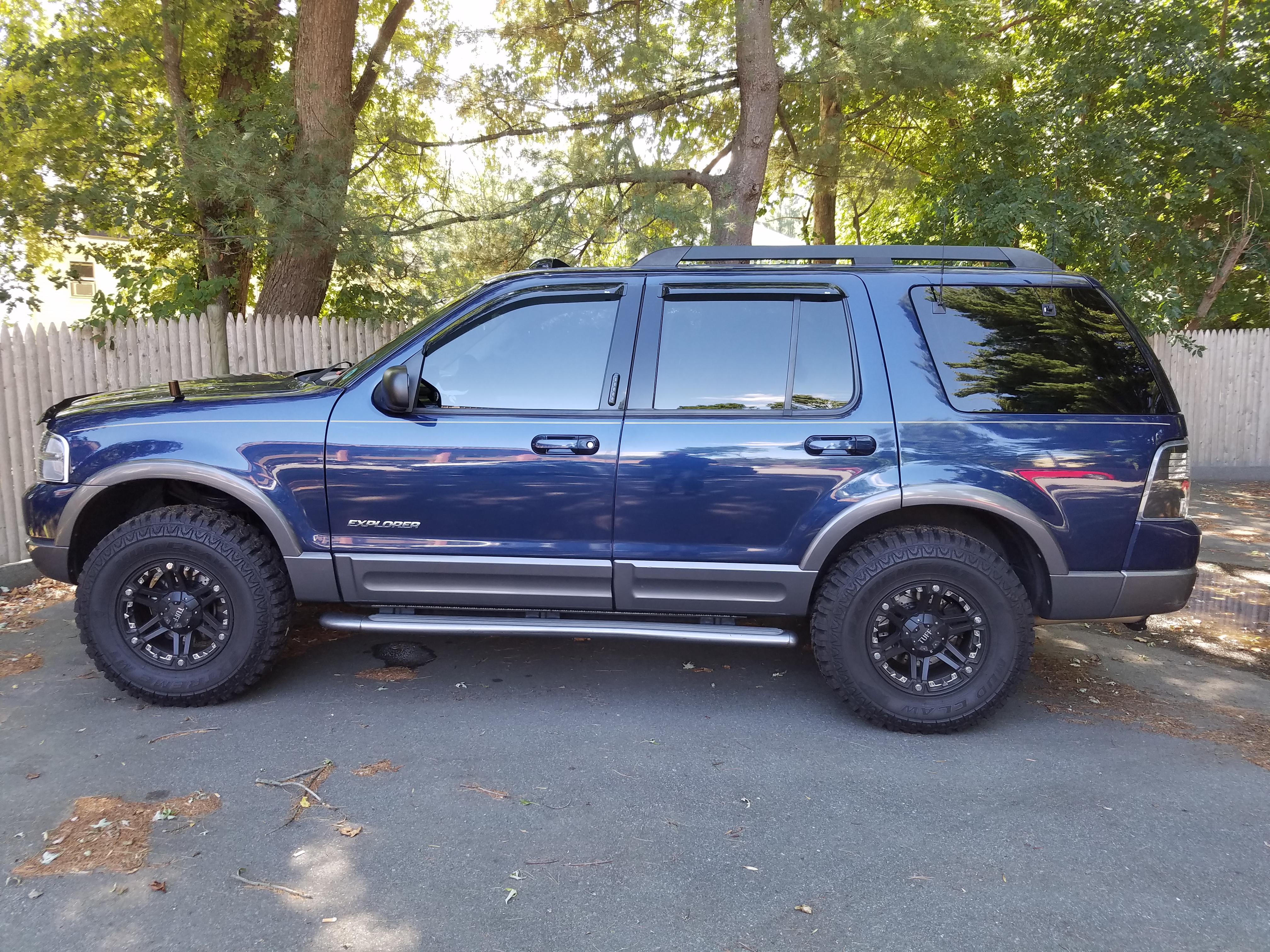

put these on last year 285 75 r 16 and my mileage went from 14 mpg to about 10.5 mpg
That looks so nice! 4.6 with 3.73's?

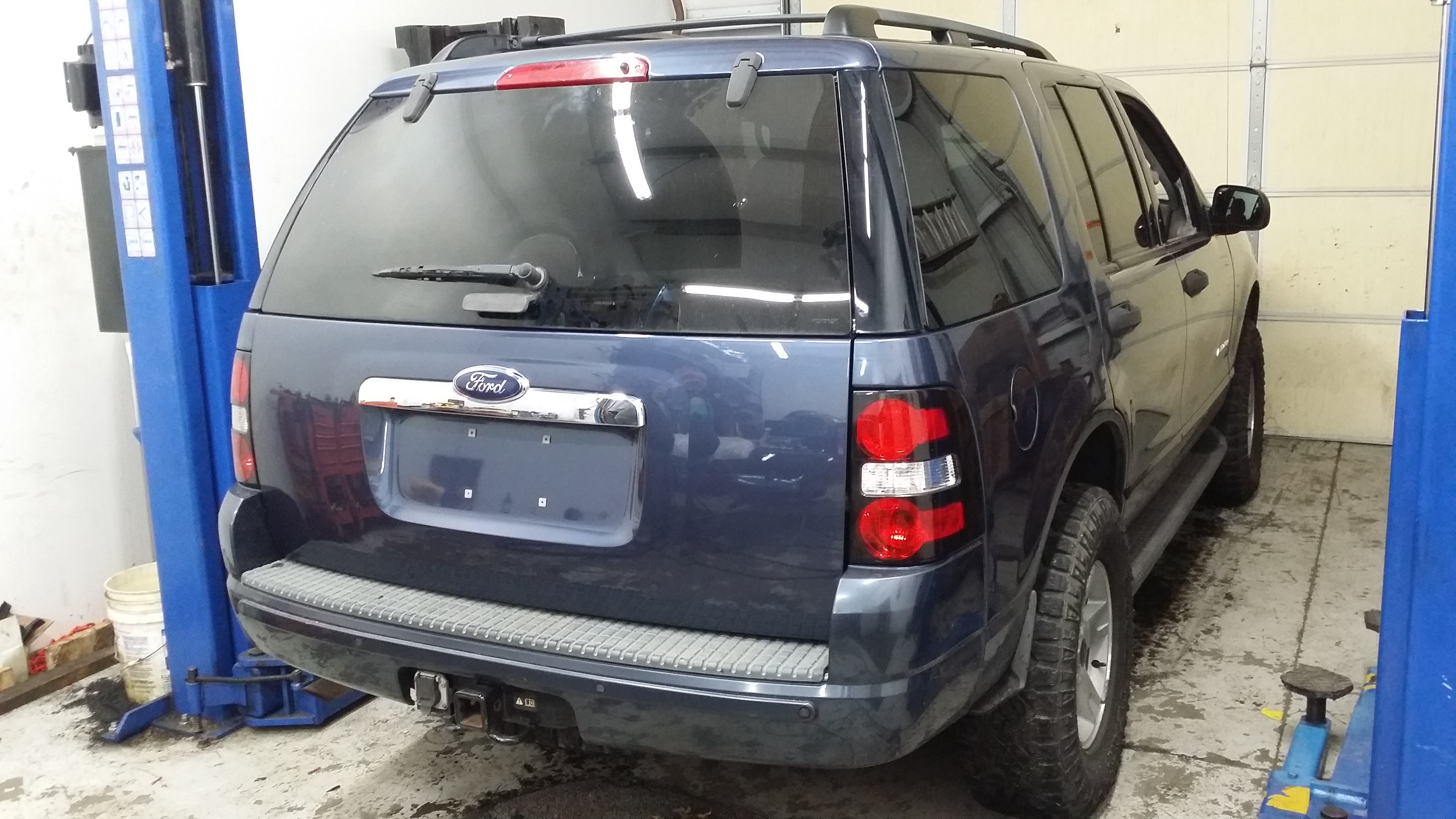

Same size/tire I'm running on my girl's 04. It has 1.5" lift rancho struts. Sorry for the poor pic, it's the only one I have at the moment handy from the hatch swap.
