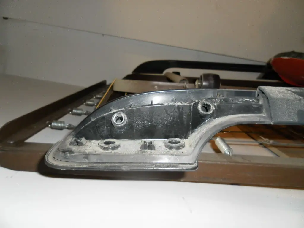

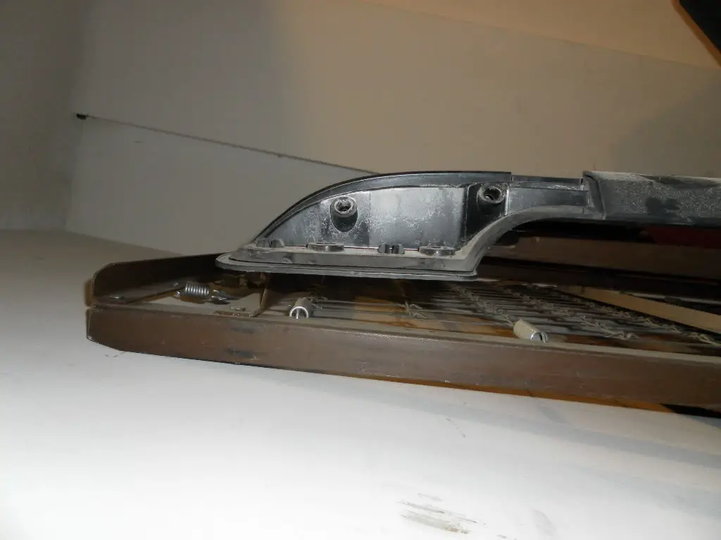

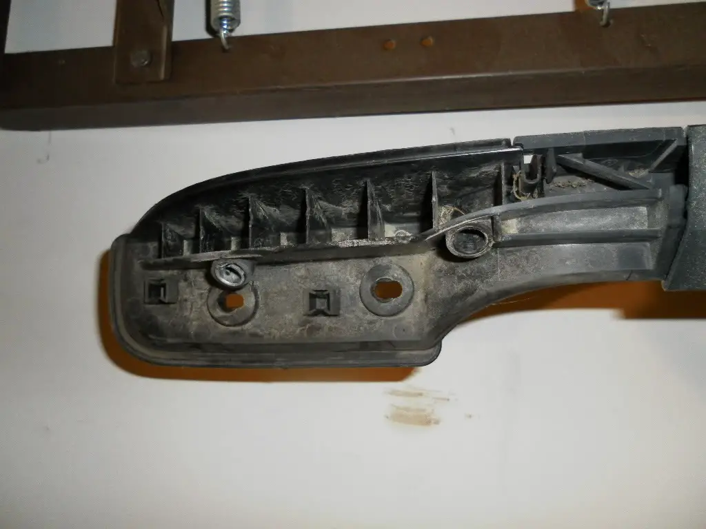

Perfect, thats what im thinkin exactly, if you dont mind could u get me one more pic, one of the mounts for the bars? Where the six blocks attach to the roof, thanks a ton man :)
You want a picture of the actual roof rack mounts that attach to the roof?
Edit: Like these???
Beautiful. Thank you. That is exactaly what i wanted, how long did it take to remove em?
About 15 min to remove the rack:D
Just pop each cap off and there's two screws. Remove all of them and the rack. Dab a little silicone on the screws threads and reinsert them. Use some touchup paint on the head to blend them in better and you're done.
