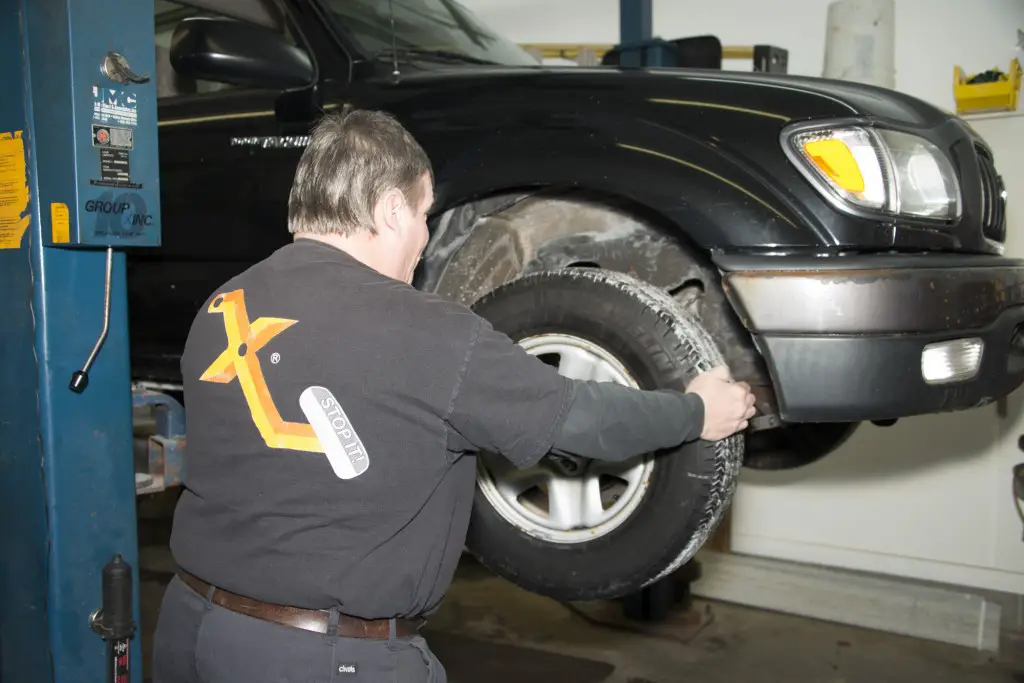

Check the wheel play by yourself. Don't trust the "shop". Lift one side and do this:
