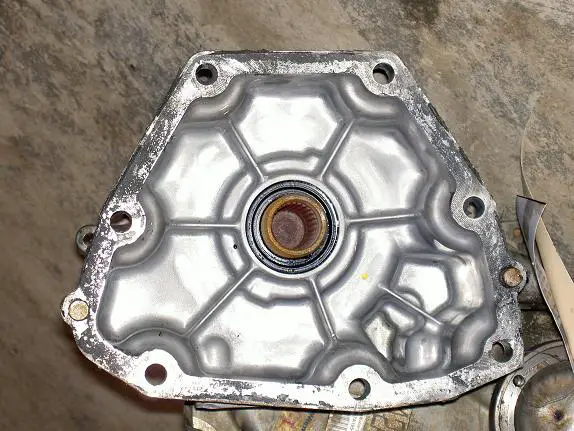

Check out the bolt pattern of this 2003 AWD transfer case below. This bolts directly to the 5R55E or W trans. Good luck,
