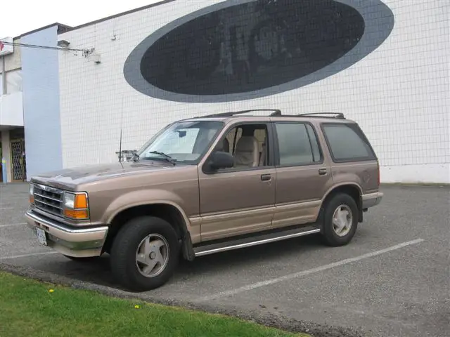

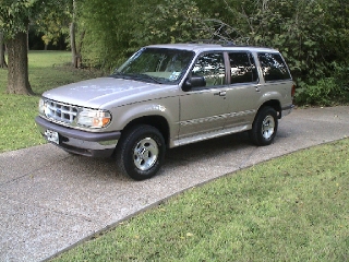

I have a 1992 Explorer and found a dirt cheap 1997 Explorer for sale. Will parts from my 92 fit the 97? Not a big deal if they don't fit...it would just be a bonus if they did. Both Explorers look identical, only they are different years and different colors.
Mine is for sure a 92, maybe this one isn't a 97 like the guy said, but they do look the same (maybe not identical) I'm just going from a quick look.
If any parts would fit that would be great. As I was just going to use my 92 as a part vehicle. Not looking for any specific parts at the moment.
Here is a 92
Here is a 97
If the truck he is selling you looks like a 92 then it is a 91-94, not a 97 like he says. That would be better, because almost everything will swap over. In 95 the engine, tranny, t-case, front axle, body, interior, almost everything but the rear axle changed.

Rear axle changed too... drums to disks.
Thanks for the info. I won't be able to look at the truck for sale until tomorrow, but at least I know that I can't use my 92 for parts on a 97 now! If it is a 97 I guess I'll sell my 92 for parts as the tranny is on it's last legs :(
