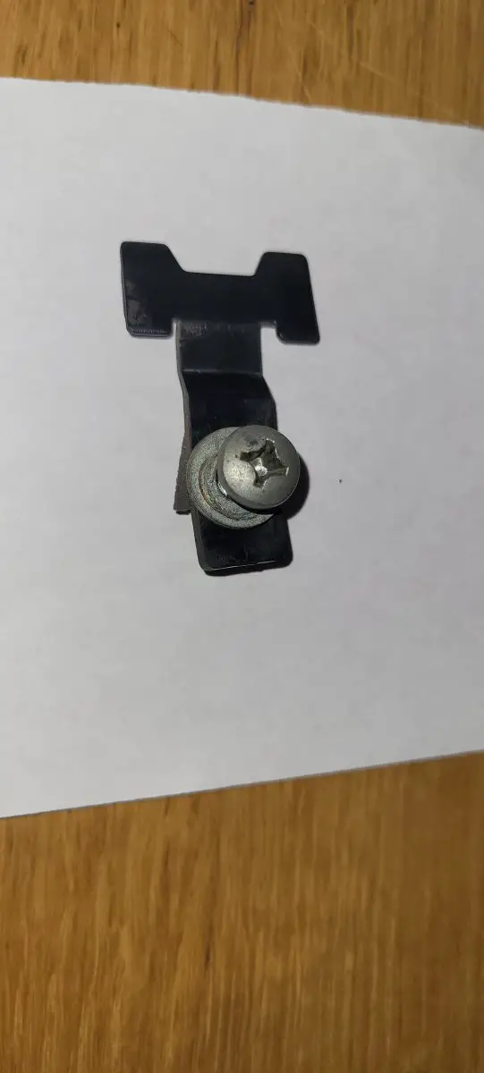

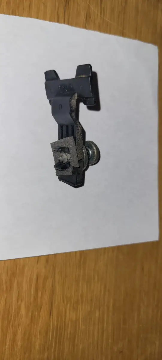

I have a 96 XLT. I was diagnosing a passenger window problem and found a loose piece in the bottom of the door. Can anyone please tell me where this is supposed to go?

I read that there is a plastic piece that breaks and needs to be replaced. Can someone post a picture of this piece, please?

I believe that is a glass tensioner. I could not find a picture in the service manual.
I suggest you look at the inside of the driver door for location. Or go too a JY

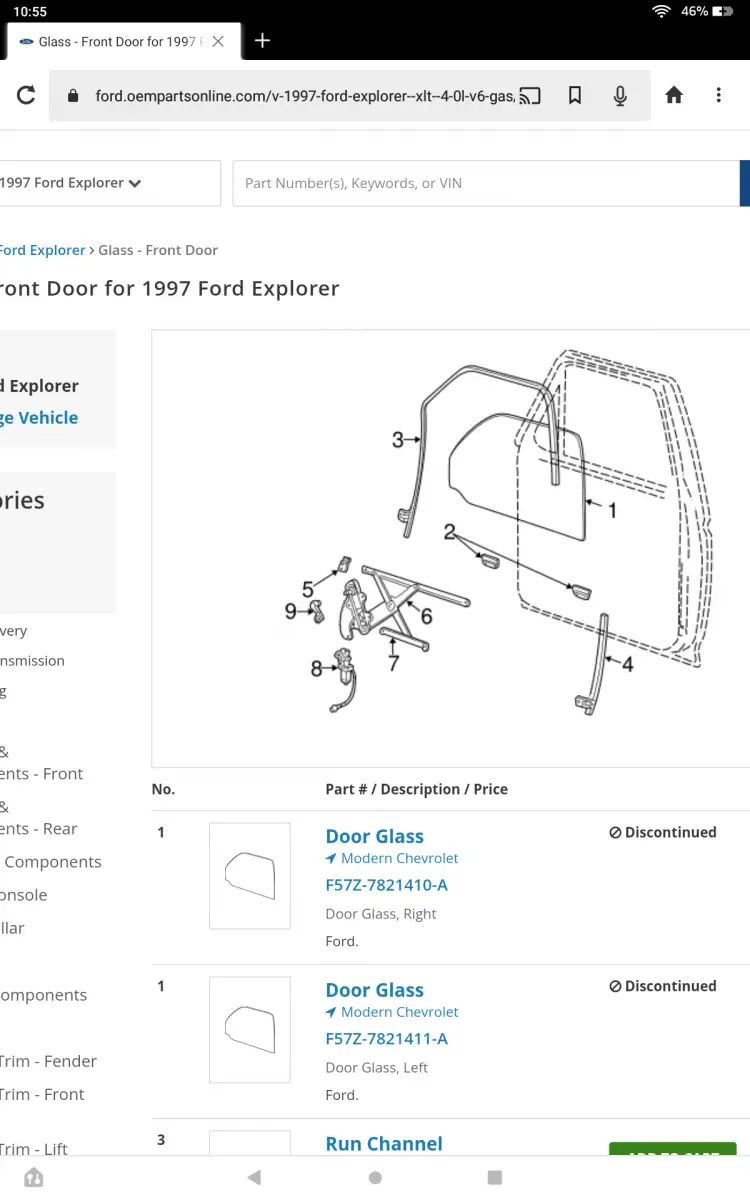

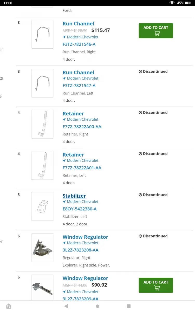

Found breakout number 5 in the picture.
Must be guide or pressure adjuster
Note that #3 in that diagram is often the cause of the glass binding, rust can build up in the channels. I replaced that in my 93's door, which fixed it. I'd replace that if possible for any glass that is biding and you haven't found a way to fix it.
Note that #4 is the one adjustment for how tight the glass is along the bottom, the one bolt loosens and the guide moves left or right as needed.
Thank you for taking the time to find that. I will look on the drivers door window to see where to place it unless you have an idea?
I will be waiting til the heat cools down here in Phoenix though. The drivers door is the only door that I did not need to work on but now I guess it will be one happy family of all doors getting some attention..
