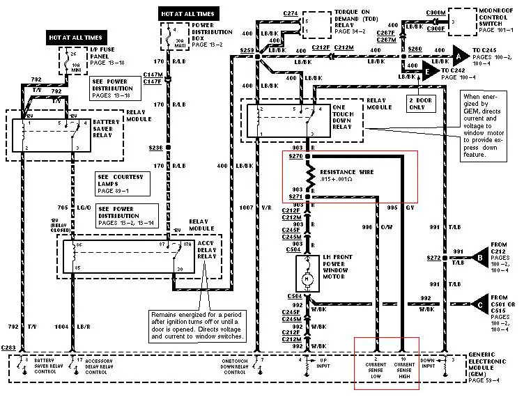

drivers window motor keeps trying to drive window up or down
any ideas?

Thanks MarT I did try that but once I finished the motor keeps trying to drive the window up or down once it stops.
Clunk Clunk ( that is the sound it makes)
What makes the motor stop driving ?
Cheers
According Ford's wiring diagram it's controlled by GEM - which get this info from an resistance wire, by measuring the amount of current on motor.

thank you for the diagram & info .
I'm not sure where to find the wire that the diagram refers to or is that inside the GEM
