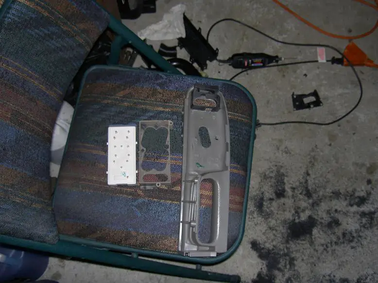

And, while I'm at it, it looked like, when I took the door panel off, that all the switches there are one mass unit. Is that correct, or, just an impression by looking at it without examining it in any detail?

Yes, the main switch on the LF door. Those switches all are one piece, and internally they have very fragile tiny copper tangs/contacts. They do eventually lose tension or bend, and then that switch doesn't work any longer. That master switch is the most used, so $60 for a new part isn't really bad.

However, the Ford dealer is telling me that the switch for the locks, and the switches for the windows are separate. When I take mine out, after removing the door panel, it comes out as one piece. The lock switch and window switches are all part of the same section. Am I missing something? Does it have to do with the 3 screws at the lock switch end of the cluster?
Thanks.
Yes, the door lock switch is separate, at the front. They all go into the same part which you aren't buying. What you will get is the large rectangular switch box, and you have to pry it out, be careful doing that. Below shows the back of the switch panel, out of the part where they all snap into.

Okay. I just disassembled a broken one, so that it looks like the pic you posted. HUGE help! Thanks. I think I have the idea now. I'm going to buy a master switch and a window motor (just in case) and return which ever one I don't need.

Thanks for the pic CD! HUGE help!
