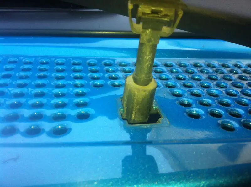

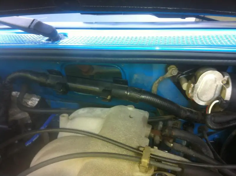

Turns out there is a removable access cover in the middle of the top section of the firewall:
Easy to get that off. Then you can reach with your hand and push on the tabs to remove the nozzle.
It came out of the hose fairly easily on mine. It was clogged indeed! I rinsed with hot water, shampoo and forced water through it using my mouth. It sprays now, but not as well as the other nozzle. Too lazy to pull it out again. Better than nothing :)
