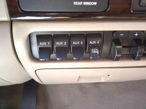

2012 has an optional auxiliary switch option.
Most are pre-wired for the switch and have leads running to the front and rear for aux lights etc.
Ford calls them "up-fitter" switches.
You will have a storage pocket or the like on the dash where this up-fitter switch kit would be.
Pop that cover/pocket, whatever off to see if your rig is pre-wired for the upgrade.
If so you can just order the switch and install yourself. Nice!

You still have the option of looking into whether or not your 2012 has the battery lead already installed for the factory auxiliary switch kit.
It is a common practice for cars to ship with all the wiring in place for optional upgrades. This way a dealer can up-sell options but not have to cut the car apart to put it in.

this^^^
may cost a bit more, but it will look factory, work like factory...and more than likely simply hook up once you take that blank pocket out and provide you with some additional auxiliary switches :thumbsup::thumbsup:

Thanks for the information on the switch information I'm going to look for it to see if it's there. At least it would provide additional Accessories to add at a later time. I'll let you know....thanks
