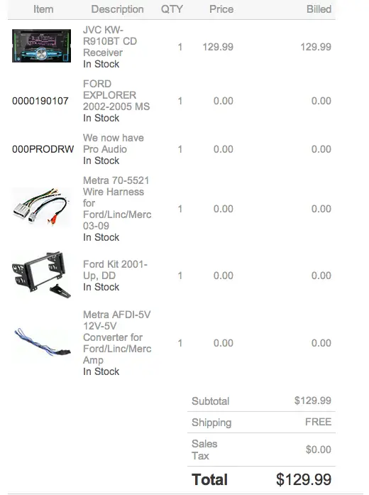

Thank you for the responses. I just ordered a JVC unit from Crutchfield.
