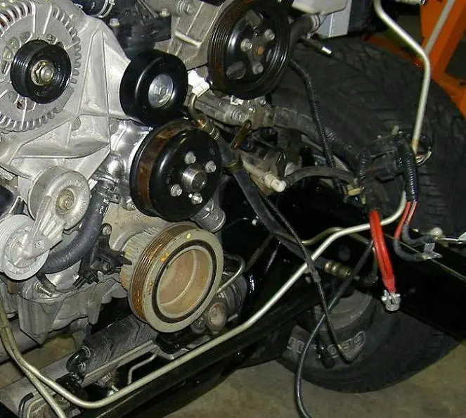

On our 07 4.0 with 125k miles, when you look down the accessory belt, you can see the harmonic balancer (crankshaft pulley) "dancing" around a visible amount when engine running.

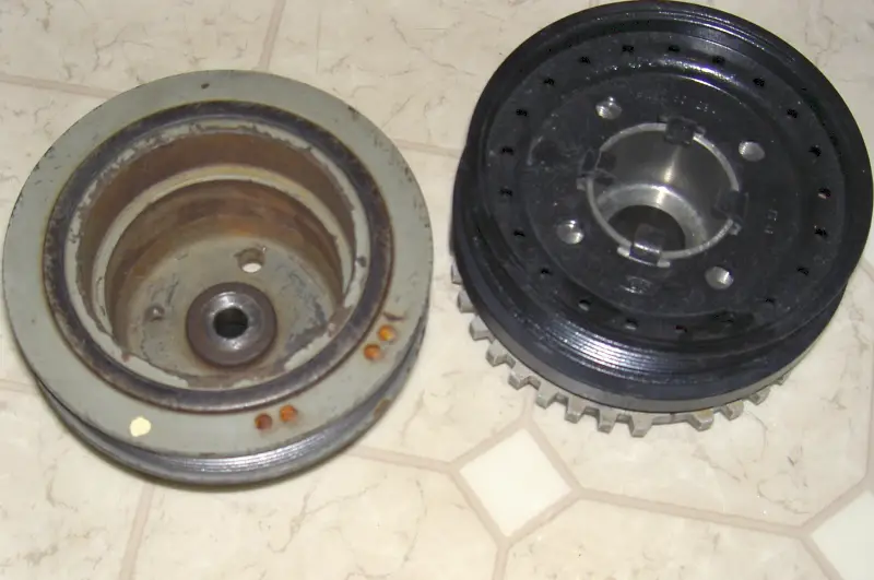

Check that out carefully, all factory balancers are two parts with a rubber layer between them. Typically when the rubber begins to let go, you won't notice it before it affects timing, performance, or a CEL light. Try to determine if the outer ring is rigid(won't move by hand at all), in the same plane as the inner ring, and if it looks to have spun at all. Look for damage to the rubber seam area, excess rubber hanging out etc.
