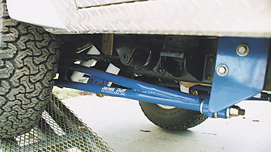

Could I install these long link traction bars on my 99 XLT 4x4? Do they really help with traction, if so how would they effect ride quaility?
#5330 Long Link Traction Bars, 2/4wd, Bronco II & 83-97 Ranger Reg Cab
or
#5331 Long Link Traction Bars, 2/4wd, 83-97 Ranger S/C
they will hurt articulation and hamper ground clearance... but i guess it is a doable thing seeing as they were available for the bII and ranger
They realy don't help "traction", they help reduce spring wrap. From my experience spring wrap is not a problem on the Explorer due to its spring under axle mounting design. The BII and Ranger are spring over which induces axle wrap, thus making these a necessary add on.
