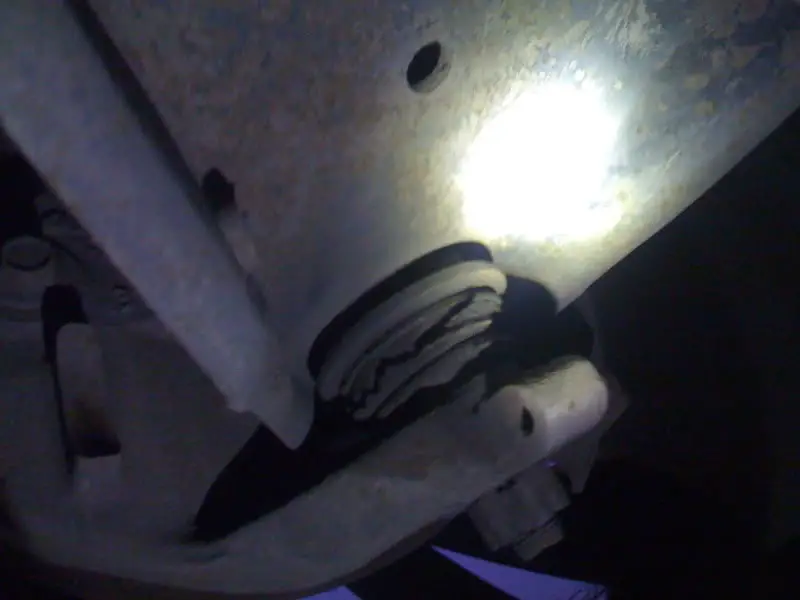

well i went and had a 40 series flowmaster put on today at my buddys shop (awesome deal on everything) and i when i got home i was taking some quick pics of it before heading out back to start the bbq pit up and well i got under the truck and noticed the damn ball joints they look like crap and about to fall apart well anyway i decided to go out and get the parts and called my buddy upa nd he said bring it over first thing in the morning we'll knock that chit out for you before it becomes a bigger problem than it is. is this the reason for my squeaking on every single bump or dip?? here the pics

Well, the boots are bad...not necessarily the joint. But with the history these things have with lower ball joints, it's probably a safe bet.

yeah... that's what mine look like. When I noticed it I was originally going to take care of it myself but I'd get it covered if I take it somewhere. The joints were still good; they did an alignment and it was holding properly.

If you want to know if its bad to the point of danger, set the parking brake, chock the wheels, and put a jackstand under the lower control arm (weight must rest on the LCA- there is a lifting tab in the front for this purpose) and shake the tire at the 12 and 6 oclock positions watching the ball joint. I dont suggest a jack for support because your hand will be at the bottom of the tire, maybe both a jackstand and a jack!
If you have anything more than negligible radial movement(1/32" to be exact), I suggest doing the Lower Balls ASAP! This checks the upper balls too.
This is the factory procedure BTW, up and down movement (according to ford) is not to be tested.
If your balls have ripped boots and they check out ok, and you dont want to replace, the redneck procedure is to put as much grease into them as you can. This will stave off some corrosion. They should be replaced soon though..and checked often.
