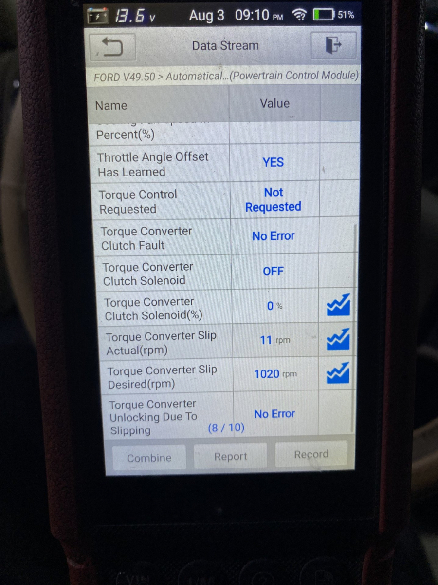

Went to my local mechanic and did a self test on the obd scan tool.
Found a code P0741- (TCC SLIP above expected).

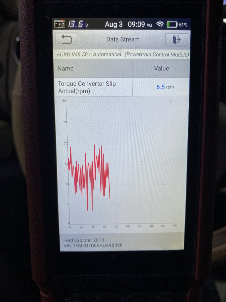

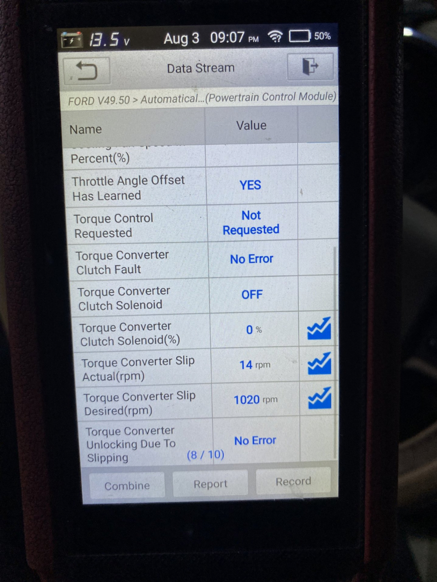

Pulled out some live data that i am sharing below..
I have no knowledge of this stuff whatsoever..
I have checked All the youtube videos and forum but cant find a proper answer.
Please share your opinion
Thanks

Thanks for the reply.
Can you suggest me how i can test these without dismantling anything.
I belive the ECT is good because i saw the reading for ECT working fine on my obd ..
