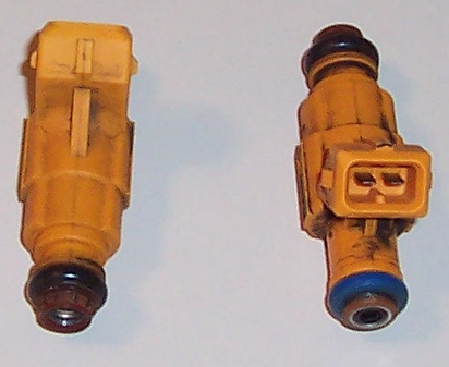

Injectors are normally color coded. Can you see the injectors to determine if they are all the same color? What color are they? My stock 19 lbs/hr look like this:
1l2z9f593ca

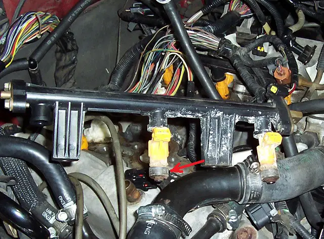

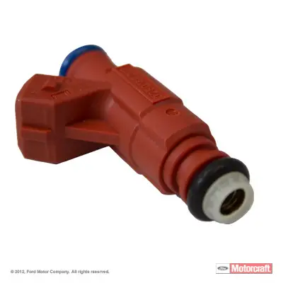

I think you should have the 24 lb/hr that look like this:
You'll probably also need the insulators (PN F77Z-9G512-AA)
since they will be brittle and break when the injectors are removed or when swapped to the new injectors.
mine are red as in your photo, the ones at the parts house are Blue. I was going to replace the seals on both ends of the injectors- is that the same as the insulators your mention. Also after I replaced the PCV and hose the codes were reset when battery was disconnected. I did have both of the other codes too i just havent drove it enough for them to pop back up i believe. thanks for the pics.

I think the blue injectors are for export models but don't know for sure. There's an O ring at each end of the injector. There's also an adatper/insulator in the head for the injectors. Often they come out with the injectors as shown in the photo. Have the upper and lower intake manifold gaskets ever been replaced? They frequently dry out/shrink and leak resulting in lean codes being reported by the PCM. Although your symptoms sound more like the engine is running rich instead of lean. Have you checked the electrical connection to the engine coolant temperature sensor?
