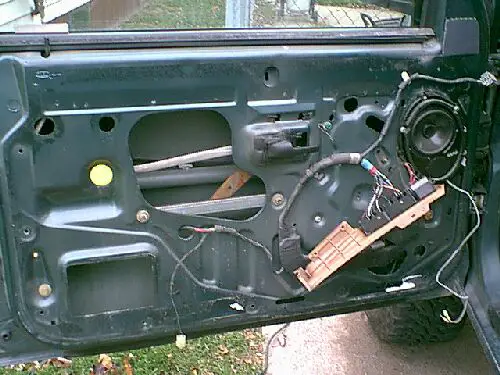

ok...well I bought a few rolls, and this stuff seems like it will work very well. I installed it on my drivers door, sad thing is, I lost my hearing in my left ear recently so I can't really tell how much of a difference it makes. As soon as I get my hearing back(Assuming I will) I will let you guys know. Heres a few pictures.

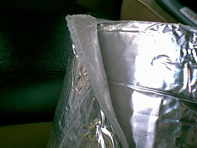

Here's a closer up picture of the foil/foam.

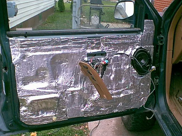

And here's the after picture. I know the job is not that great, but I had never done this before and learned quite a bit by doing this door, so the next one should look better.

looks like a job well done. hope ur hearing comes back soon
