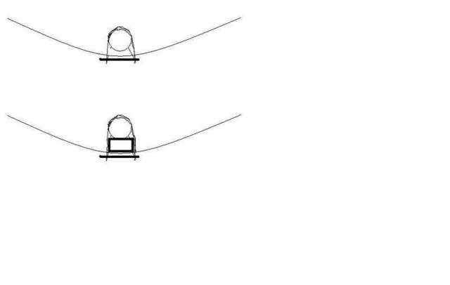

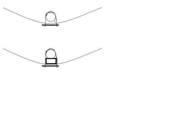

Ok here is what I could come up with. This is a side drawing of your leaf set up. The axle is the round circle, the long arched part is your leaf pack, the crappy looking lines are your u bolts.
The idea is you put blocks between your axle and leaf springs, lowering your ride hight keeping your existing springs. You will need a block and some longer(EDIT: U Bolts) leaf springs. I hope this helps. Auto Zone sells kits with blocks and u bolts off the shelf.

Mountaineergree you said longer leaf springs?
i believe you mean 'longer U-bolts' not longer leaf springs...if not feel free to make fun of me
Yeah, its longer u bolts, I was tired. :confused:
