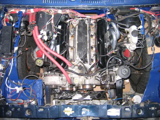

On my BII I dont even have that metal manifold, I jsut took rubber lines directly from the engine to the heater core
BII setup, (I ended up ditching the big red hoses and using smaller black ones, thank goodness)

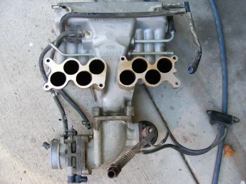

on my 96 I have that metal manifold, but the hot water feed to the upper intake are bypassed, or basically a rubber hose connects the two ports.

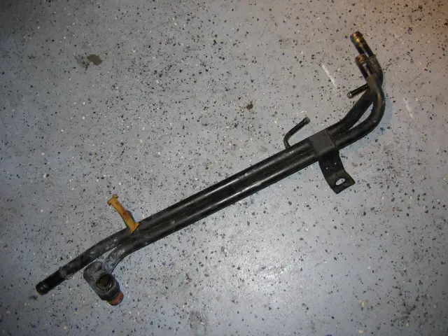

Here is the metal heater core manifold:
you can see the two small tubes that would normally feed the upper intake hot water thingy, on my truck it has a rubber bypass hose from one metal tube to the other, I believe in my BII (p heads) it was like this from the factory.
as far as I can tell the metal manifold that runs along the pass side of the lower intake and feeds the heater core is there just to make more room on the pass side of the engine for spark plug wires, etc, it cleans up the routing of heater core hoses all the way to the back of the engine.

410Fortune You wouldn't happen to know the actual name of that part, by any chance. A friend of mine had hers bust on her 2000 Exploder and we can't find it anywhere because we don't know what to call the darn thing lol.
Yeah the Explorer part is discontinued from Ford. Do you know if the two are interchangeable, save for possibly some slight modifications?
You would definitely have to modify; in what way I couldn't say.
You can also just use heater hose the whole way - you'd just need to get the right fittings to match everything up.
True, the only problem with heater hose would be deleting the temp sensor.
The "Mustang" version seems to be a pretty close fit, looks lie longer 1/2" heater hoses to the heater core would work, as long as they don't kink. You'll need to make that bend on the end out of rubber hose , but I bet it is doable.

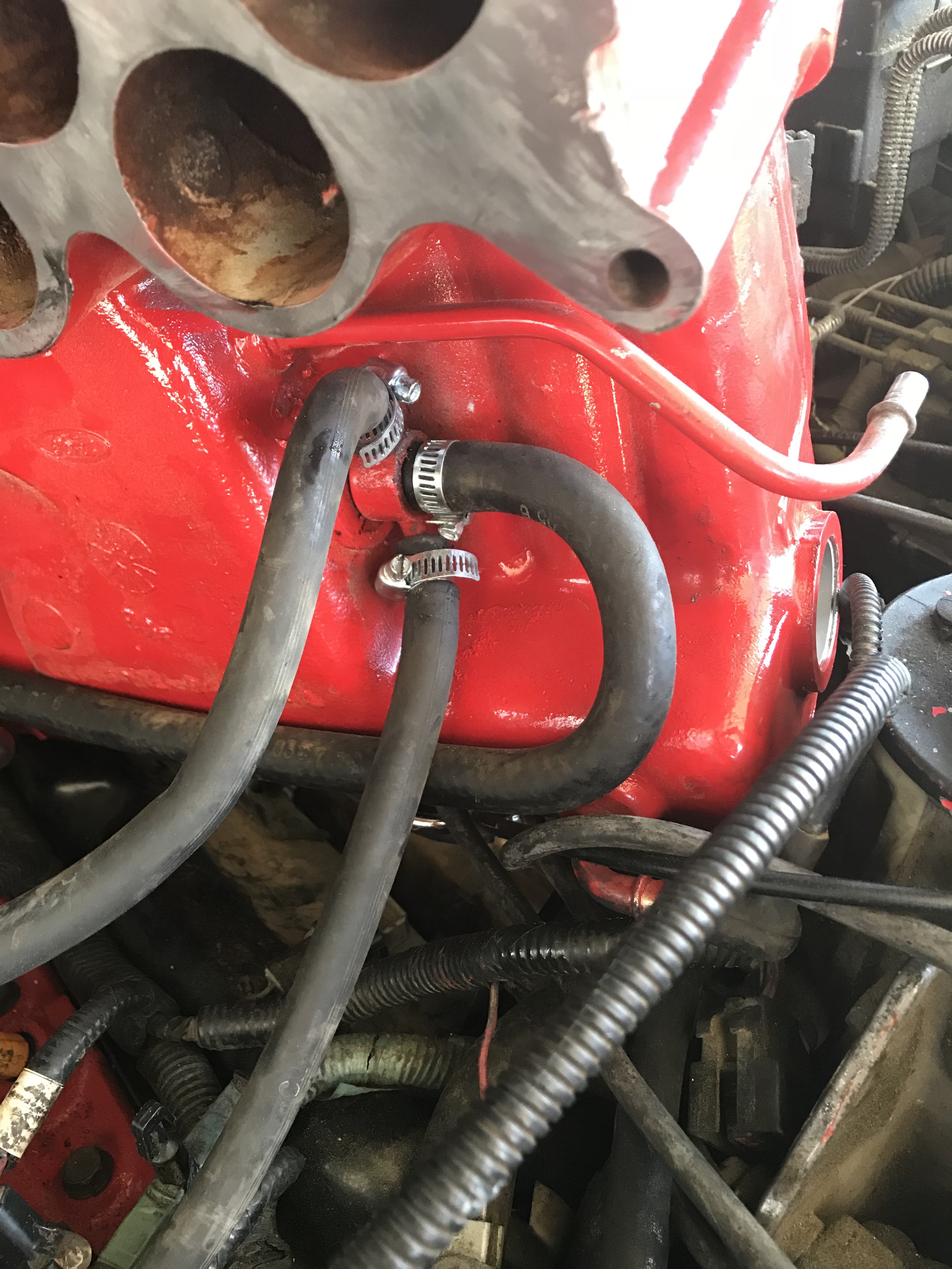

Is this the correct way the two water hoses connect on upper intake 97 exployer 5.0? They are the ones beside each other. Curved one goes to PVC Valve. ??
Although it looks wrong, as if the coolant will enter the vacuum tree, I think you got it.
Mine looks a little different but the coolant lines do attach there
Thanks Turtle.
