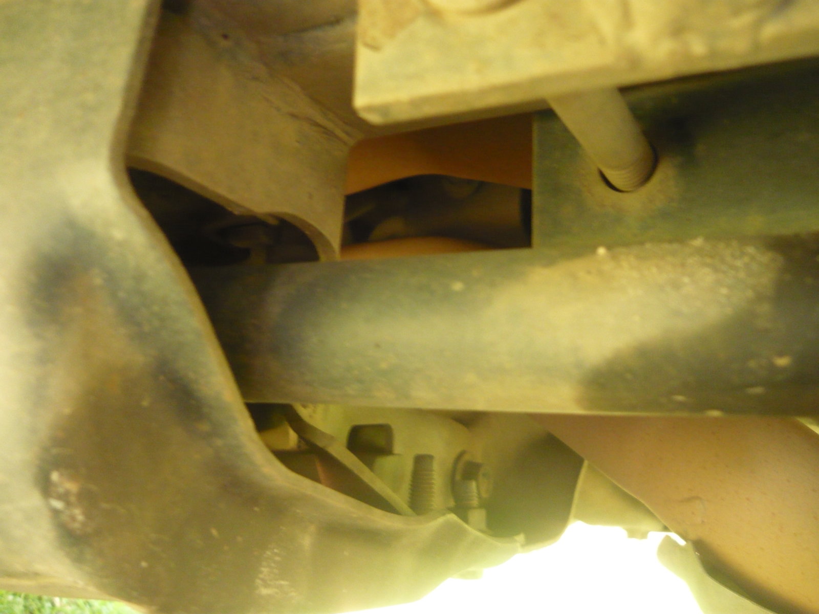

Driver side engine bay showing down tube clearance, looking in under the upper control arm
Driver side ( bank 2) down-pipe drive line clearance. No room for a cat converter here either. Note bank 2 sensor 1 ( upstream tuning o2 sensor) location. Cat has to be under the transmission to fit.

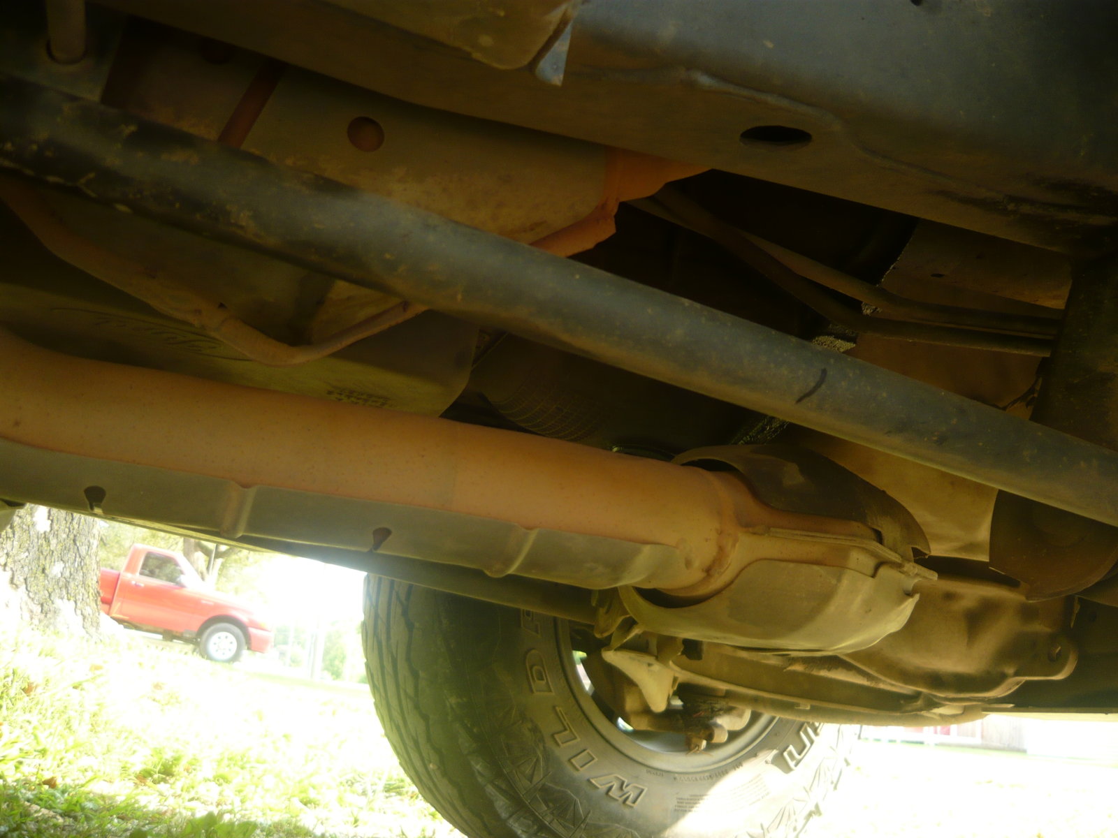

This shows driver side (bank 2) tube running under driver side ( bank 1) primary cat
Bank 2 pipe now bends back up to run along bank 1 pipe under cross member
Then along the side of transfer case tucked in the side of skid plate
To the rear cats - Rear 02 sensors are in tubing upstream of these.
