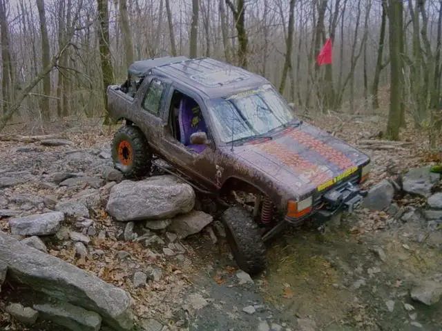

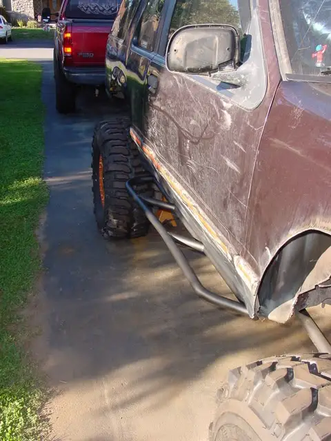

mine.
1/4" wall 2"x3" square tube, with .120x 1.5" tubing added.

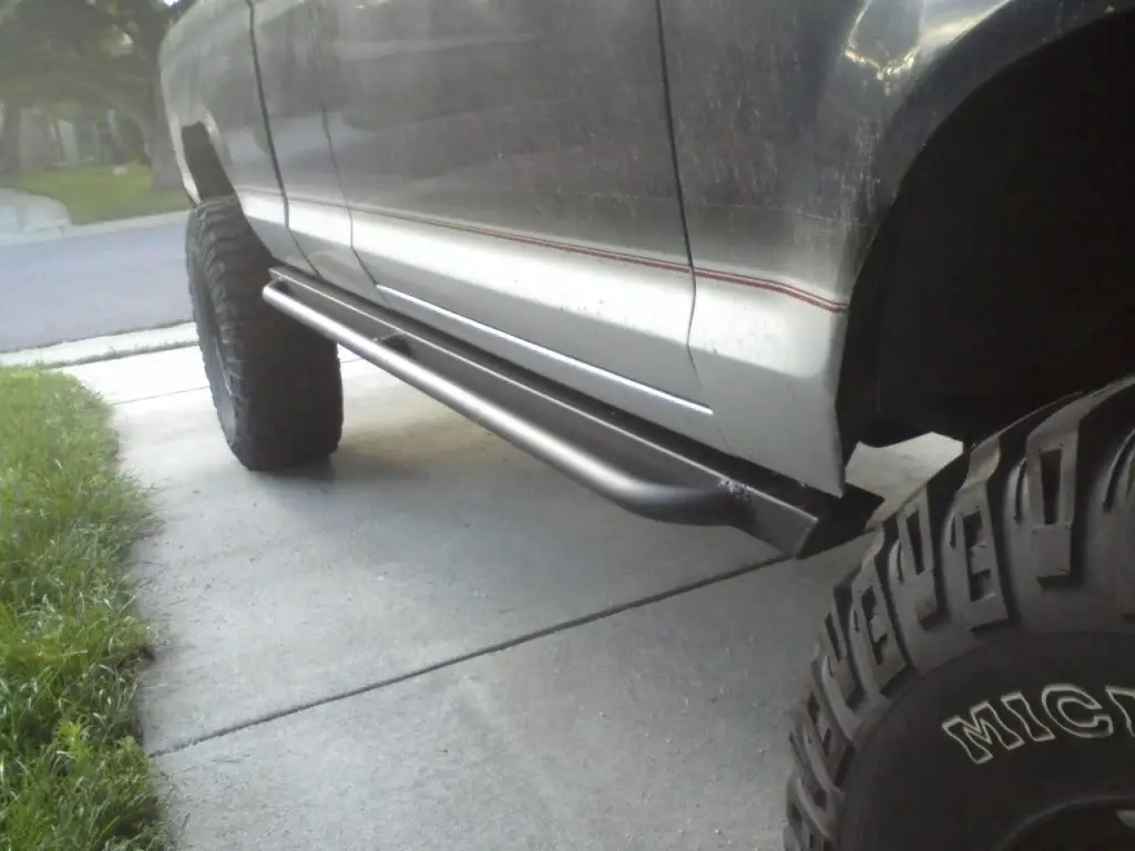

Mine is just waiting for warm weather to get them welded on. right now they are on my patio leaning against the fence.
Tim

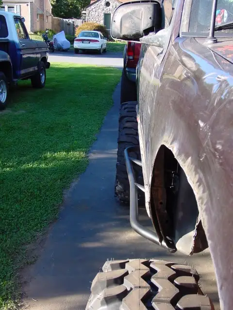

Here's mine:
These are getting pretty beat up but are still doing the job. Sometime in the future i'll make new one's from square tubing and cut out the rocker panels to tuck them up higher.
The ones I've built are linked above and here and there are more of mine and others here

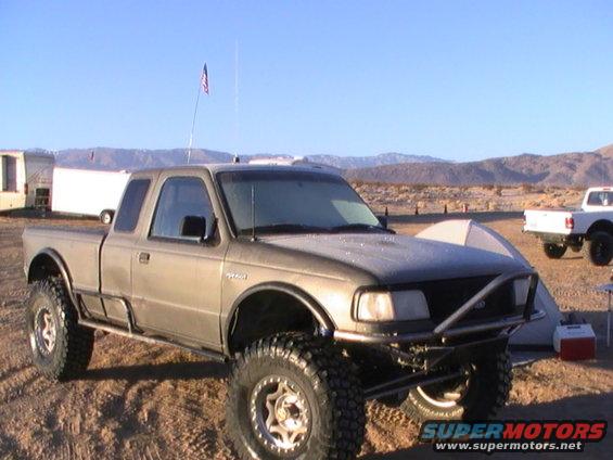

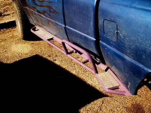

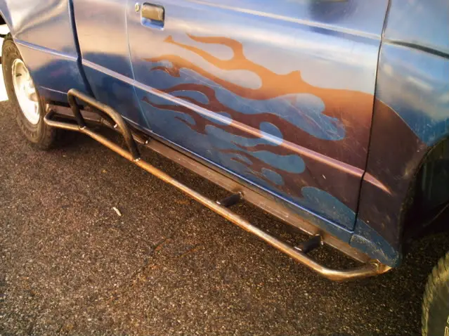

Oh, to help add to the thread, here's my Ranger sliders: :D
BBPfab.com built mine.
I cut the rockers out. The sliders are no lower then the stock rockers were.
And they get used.
Damn those stick out far...nice though..
They really don't stick out past the tires.
I designed them to act as rub rails also. I pivot past trees and rocks off them. If I would have just done a standard slider, the rear tires would get hung up on stuff.

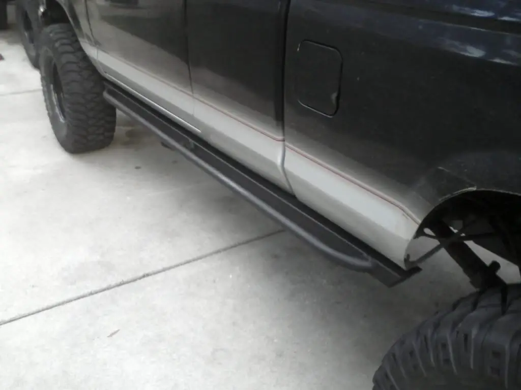

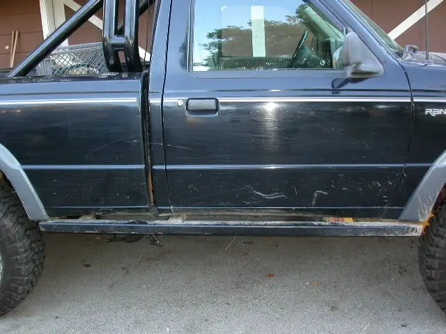

Here's mine
in progress
Finished
Ignore the funky paint - they're black now

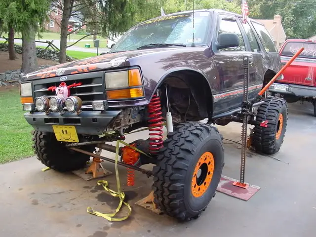

mine
