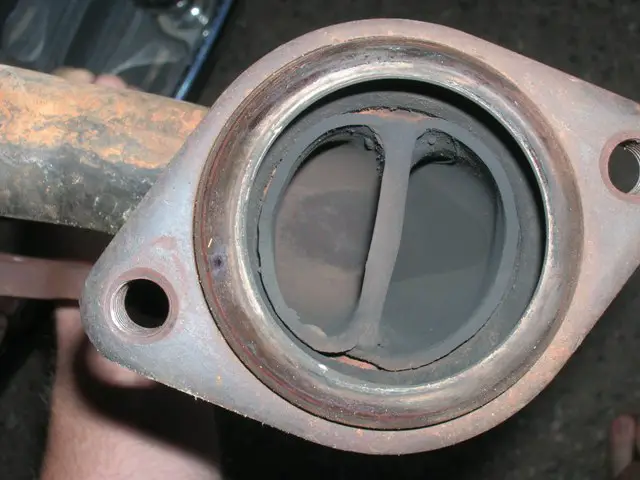

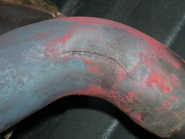

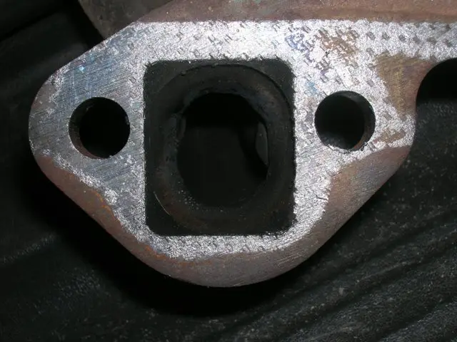

So just a quick update, have had the new manifolds on for a few months. Really easy to change I was surprised. All I had to do was fab up a new bracket for the oil dipstick tube and all the rest was super easy. Anyways here are some quick pics. The first one is the Crack in the drivers side tube. It was under the heat shield. Second is of the way smaller exhaust ports than the cast ones because on these the weld is inside the tube. Third the collector, the cast ones are full and open not cramming everything in there. Then last to report between changing a primary bank 2 O2 sensor that was lazy and these manifolds my mileage has gone WAY up. Was at 10.5-11 around town, Now its at 13.5-14. 3 Better! Also freeway was 15-16 and is now 17-19 depending on wind! I love it and way worth the $100 for the new style cast manifolds! Thanks again to Jon for his help.

Also ill look for the pics of the two sitting together, old and new manifolds. Big difference. Laptop lost hard drive a while back but should be on my external. See the pics of my old ones in above post with the collector? See how the two pipes come together? That is all open and free with the cast ones. Also see pic of the exhaust port? The tube ones are welded inside to the mounting flange that takes up the size of the port. The cast ones don't have that weld so they are bigger there as well. You will see the difference when you swap them. You will be amazed at how much better and bigger the newer cast ones are.
