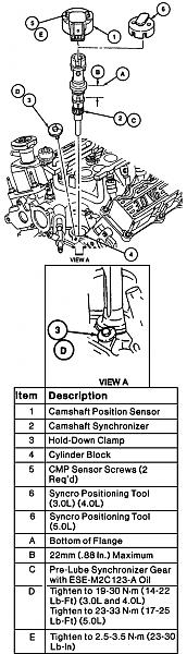

This thread will help with Camshaft position sensor alignment
the Haynes and the Chilton's manuals sure do scare a guy on this subject. Ford motorsports aren't much help either. they sold me the wrong "special"tool three times now. Manuals say if not aligned or synchronized serious engine damage could occur.
Info on the procedure here
http://autorepair.about.com/library/a/1h/bl025h.htm
Tool available here--
for 96-98 v8
http://www.autorepairmanuals.biz/site/573683/product/OTC6469
# TSB #13180 -- INFORMATION REGARDING CAMSHAFT POSITION (CMP) SENSOR ALIGNMENT TOOL CHART. *MJS (NHTSA ID #6090538, SEPTEMBER 01 1999)
and it looks like this

Okay so with that tool, I take the top off the cam sensor, install tool, bring #1 to TDC then install the sensor into the block in the position where I marked it?? thanks for saving my ass with your first post on this board ever, years ago.....
Exactly
Install tool on sensor, Get #1 at TDC, then just drop it in. doesn't matter which direction the assembly is facing, as the tool aligns the whole assembly, stator-sensor, so it triggers when #1 hits ignition.
Get it?
Although facing forward makes it easier to connect the plug

When you install the sensor, the tool is locked on top of the synch drive, slide it in and it rotates a bit as the gears mesh. Mine sits about 5:30 not quite 6:00( straight ahead) when it dropped all the way in. Did you save the stock oil pump drive shaft? It needs to mesh with the whole mess also, You'll feel it.

You mean the alignment tool gets inserted into the top of the camshaft sensor, locking the stator position in place, right?

I refer to the shaft and stator as a synch drive unit, the plastic sensor that screws to the top is actually the sensor. The part that needs alinged, or synched, is the shaft assembly. You definitely know what to do.

Tip for reinstalling if using CMP positioning tool:
Dan using the cam synchro alignment tool is very easy to do. After installing the camshaft and about to reinstall the synchro you will ensure that piston #1 is at TDC on the compression stroke. Make sure it is TDC on compression and not on the exhaust stroke. Once the #1 piston is properly placed then just take the top cap (camshaft position sensor) off the camshaft synchro. You will see a little half moon shaped piece of metal in there. Take your alignment tool and slide it onto the synchro body and the little half moon piece. To get the tool on you will have to align things a little bit. Just take a good peek at the tool and you will see which way things will have to go. Once the alignment tool is popped on then things are properly aligned. Next install the whole unit into the engine. It will take a try or two but you are looking to get the synchro's positioning tool arrow as close to forward facing (stock position) as possible. If it is not forward facing then pull it up and rotate over to the next gear tooth. Keep trying till you get the proper tooth that allows it to face forward the most. Do not worry if it is not perfect. As long as the synchro is locked into position to the body and the piston is aligned properly then your cam timing will read properly in the PCM. Once you get the synchro in then bolt it down tight. Once that is done you can remove the alignment tool and install the camshaft position sensor piece and then you are done.
While the above paragraph may seem complex and wordy the process itself is very straightforward and easy to do. It is more or less a restatement of what was said before but hopefully I was able to put it into the right words where you can understand it.
Tip for reinstalling if NOT using CMP positioning tool:
If the synchro is still in the engine and you know it was timed correctly before then you can remove the top cap (camshaft position sensor unit) while the synchro is still in place in the engine. Then you will reference where the little half moon blade is in relation to the body of the synchro. This will allow you to reinstall the whole synchro assembly later and still keep things aligned. If you want to you can mark where the body of the synchro is in relation to the engine itself. These two reference points are all that is needed to reinstall the synchro properly. You will still want to make sure that when you take these reference points and when you reinstall the synchro that piston #1 is at TDC compression stroke. Once that is done then reinstall the camshaft position sensor onto the top of the synchro and bolt is back down with the two 6 or 7mm bolts.
