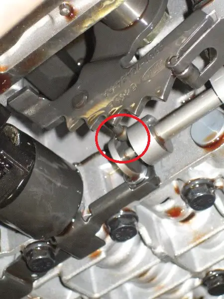

ok i just replaced my valve body gasket on 2000 explorer and have no foward or reverse and i found this thread and noticed i did not hook that plunger connection back up as well.
and that plunger thing will not move please tell me i don't have to take the entire valve body gasket off to get it to move is there a few bolts i can just loosen or take off to be able to slide it
EDIT: for anyone wonder you don't have to take it completely off loosening up all the bolts helped me and i took maybe 5 or 6 out then torque them all back
