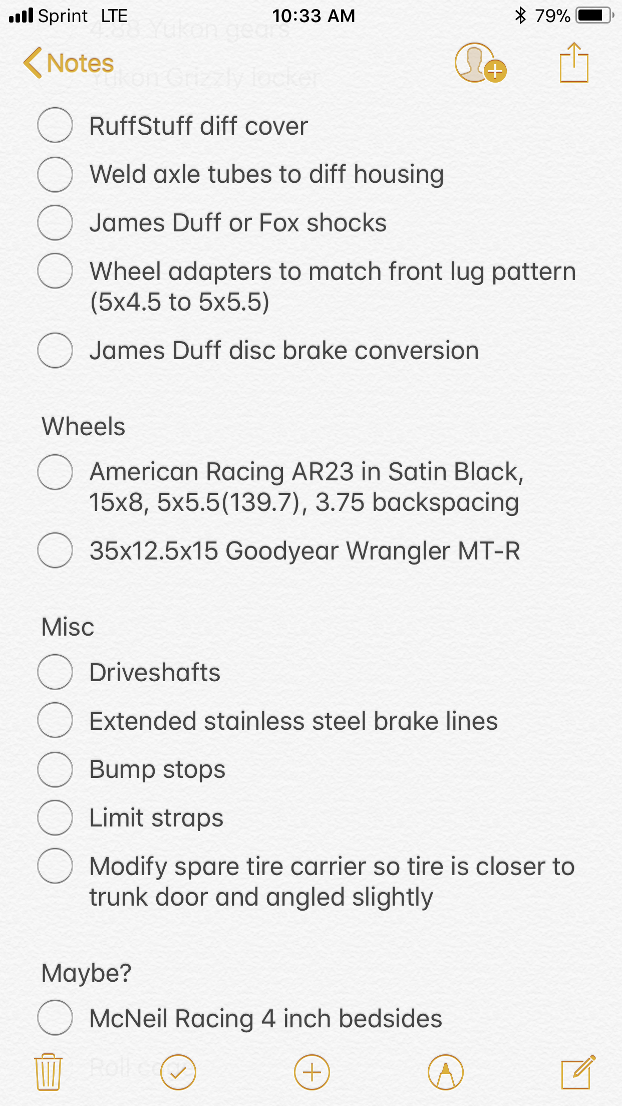

Been a while since I’ve updated this. Just been super busy with a lot of stuff. Haven’t really had much time to work on the Explorer unfortunately, but I have come up with what I’m calling stage two of my build
Just need to find a second vehicle before any of this can happen haha
Tell me what you guys think and any suggestions you might have
That's an impressive list!
Instead of converting the drum axle, get a disc axle, and build it with the super 88 kit. No spacers needed with those axles, and you get better axles, and a c clip eliminator.
Duff shocks are a cheap shock, and a single fox will be better than 2 of them, imo.
Actually that’s a good idea. Proably a bit easier just to get a different axle
I’ll have to keep that in mind about the shock. I like the idea of dual shocks just because the front has that setup already

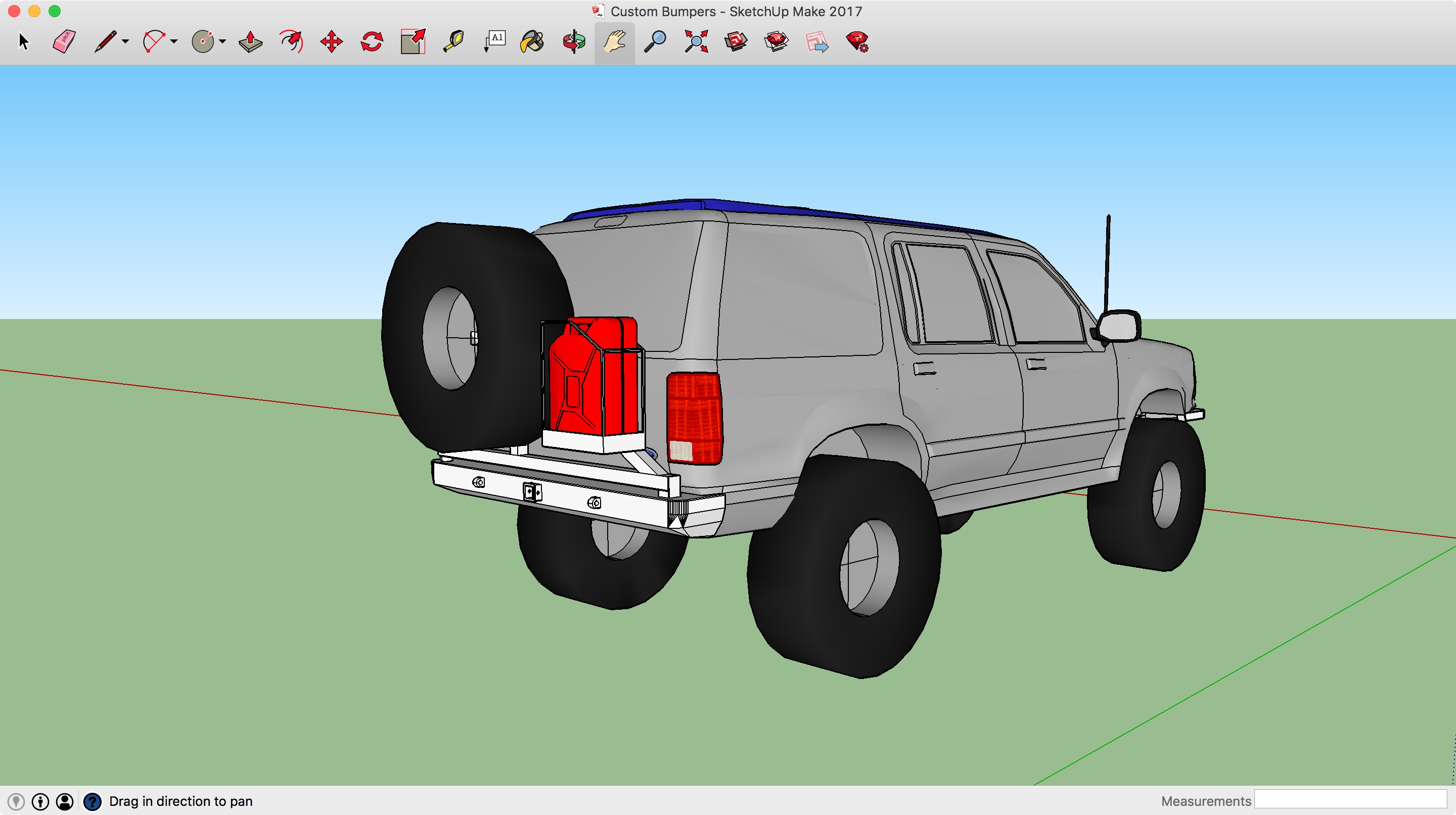

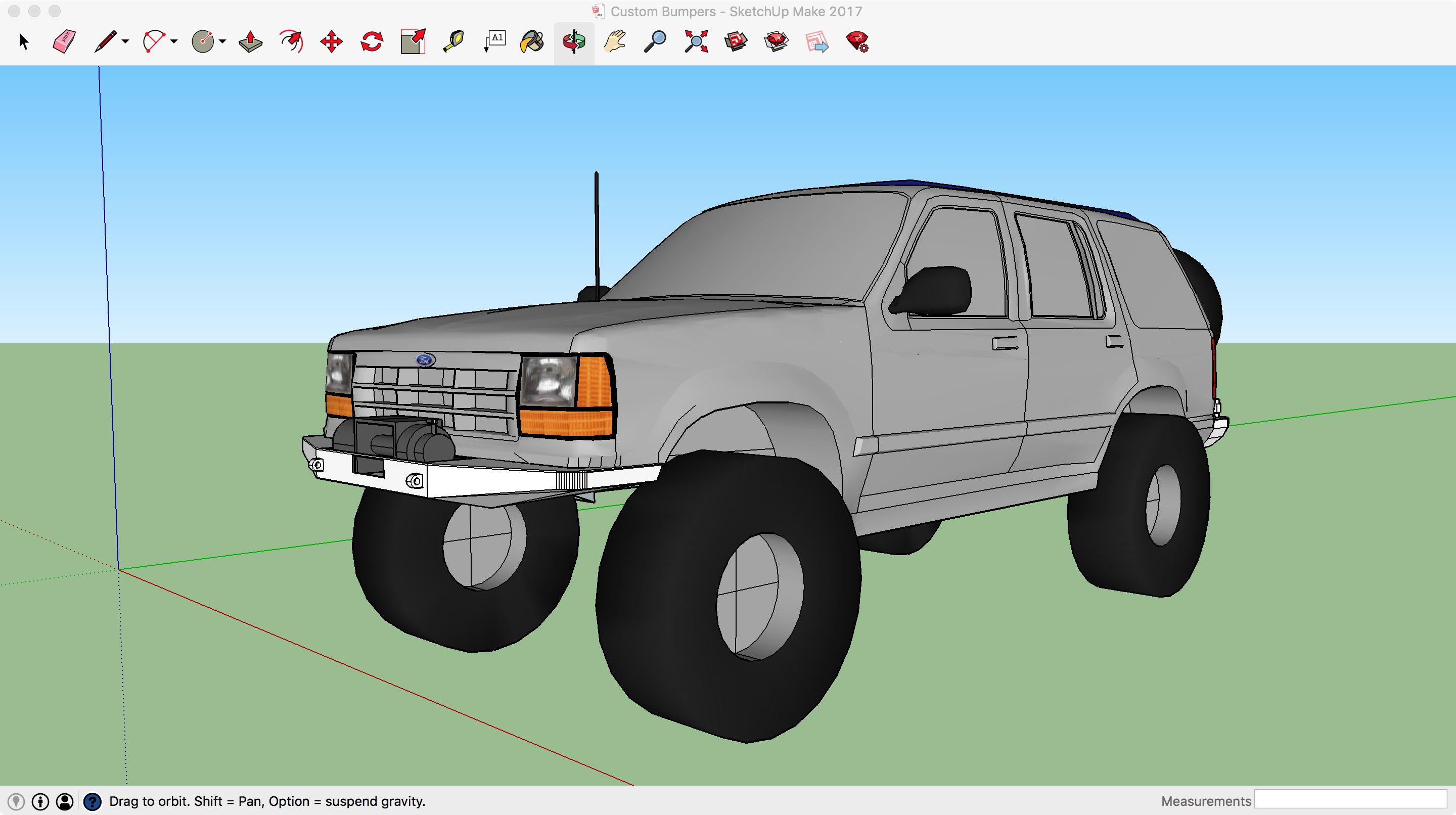

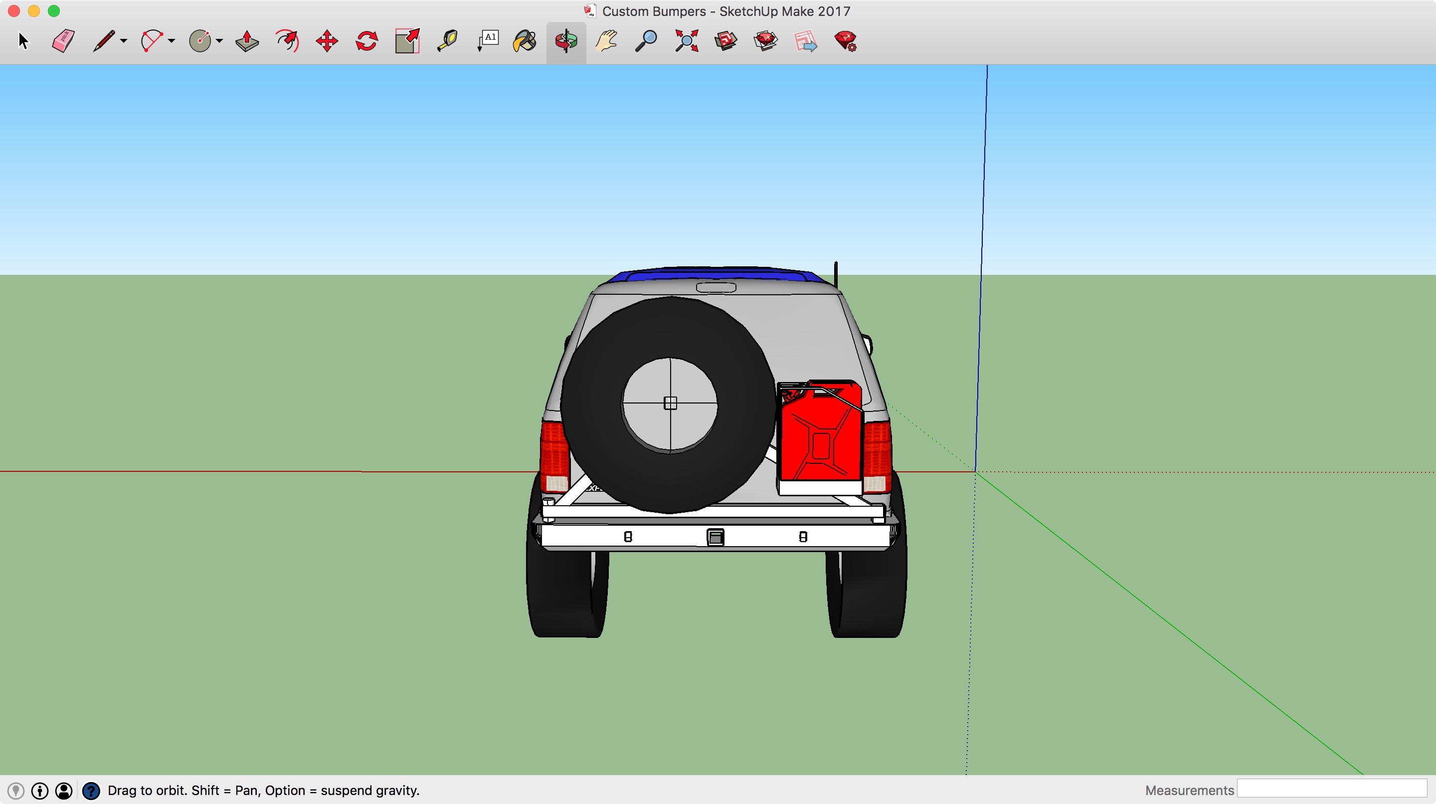

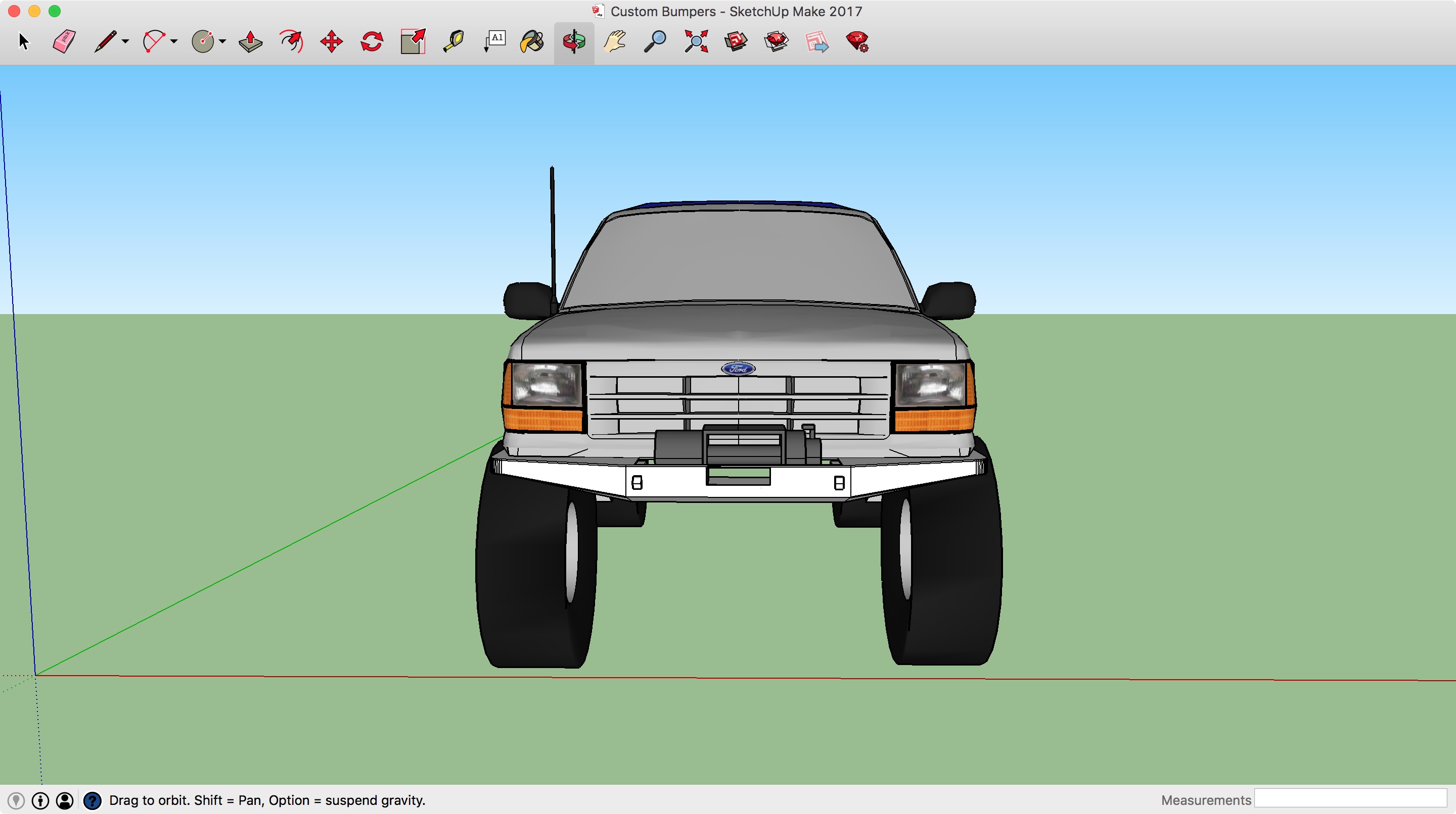

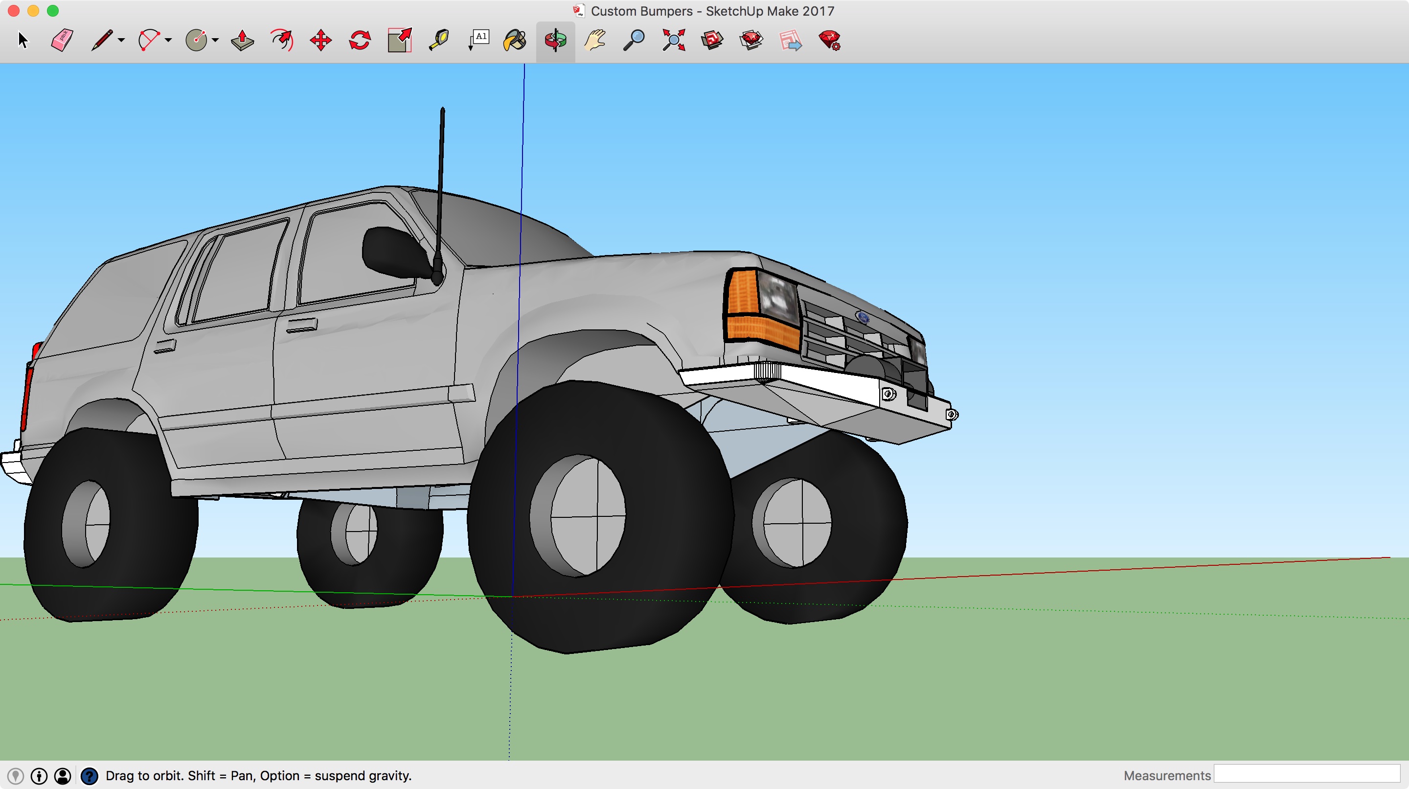

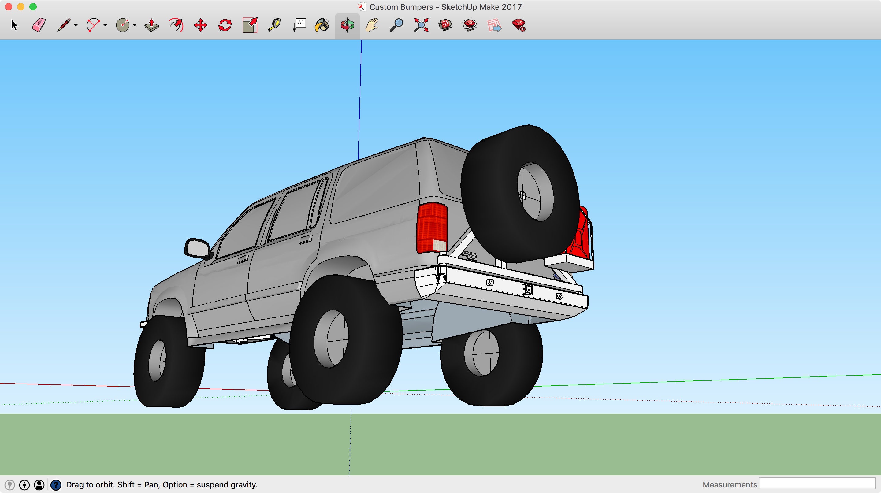

The other thing I’ve been planning are some custom bumpers. Did some models for them and I’m liking the look
My models also give a bit of a peek at what I’m planning for solid axle swap as far as lift height and tire size goes

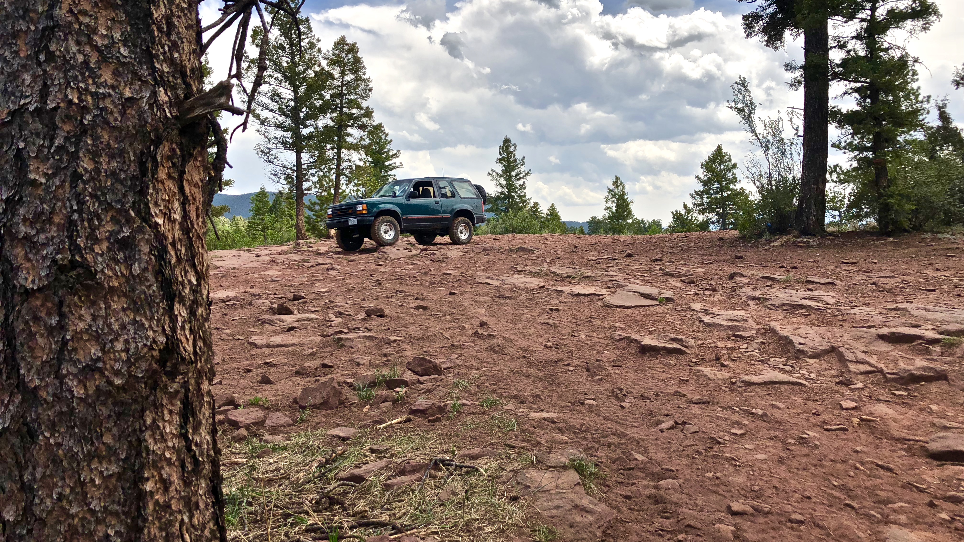

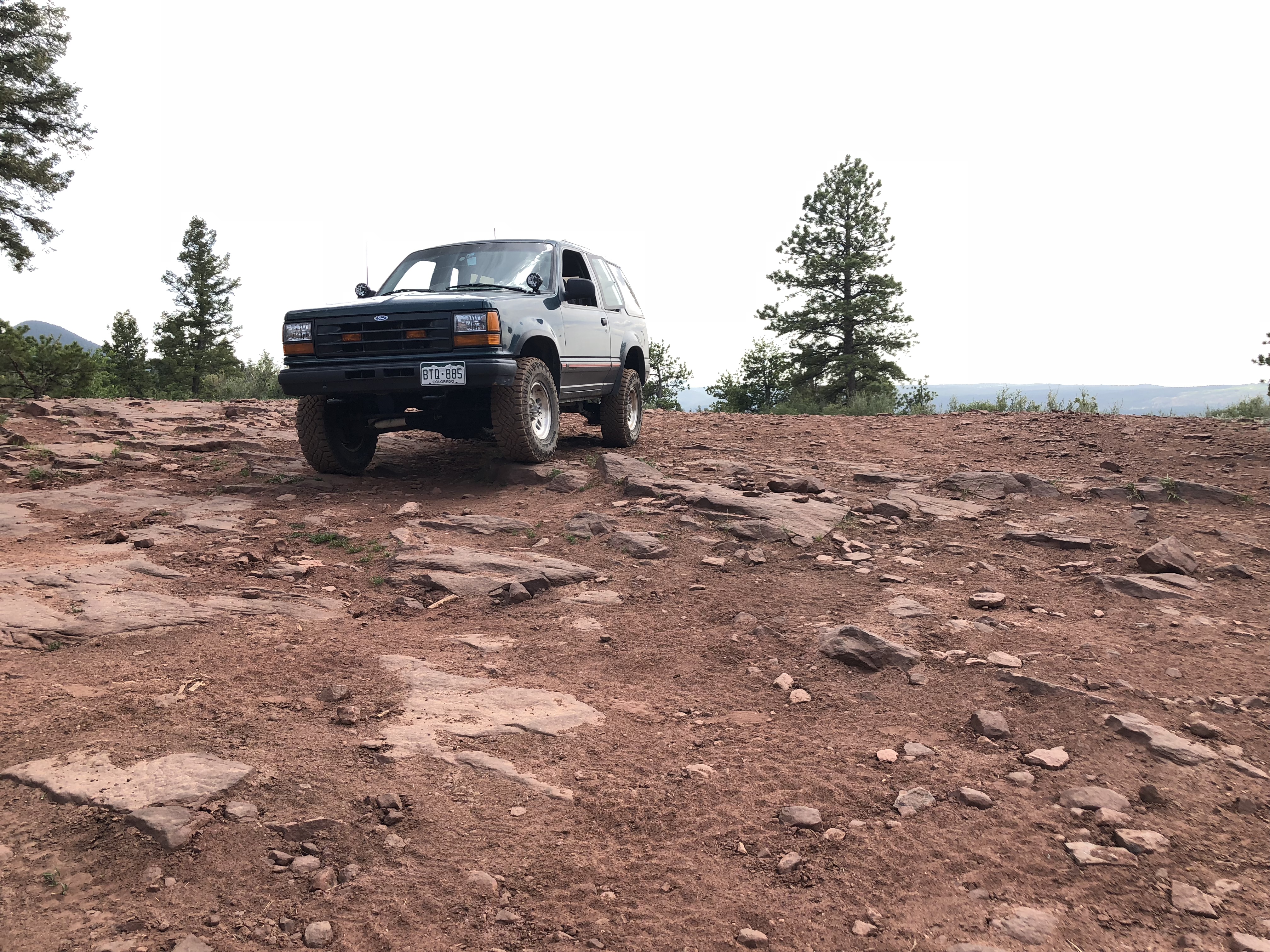

Got to spend most of last week camping for my birthday. It was very good to get away for a while! We stayed just outside of Woodland Park. Even got to run Rainbow Falls. First time I’ve been able to go wheeling since Augusto_O
No guarantees, but I’m thinking I’m gonna be building my front bumper within the month here. We’ll see for sure;)
Looks like you had some fun. Next Month I plan to take my son out there for a little while. I like going there. Great camping and a place to really test your rigs Flexibility.

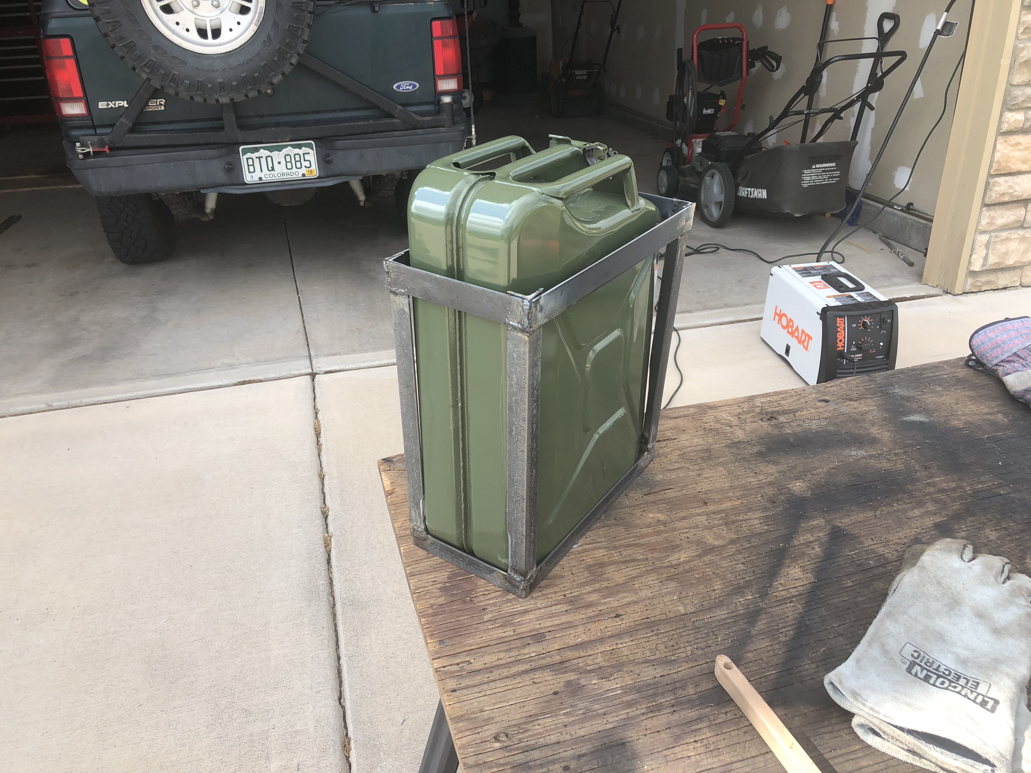

I bought a NATO style gas can recently and needed to make a mount so I can put it on the tire carrier like I had always intended to. Made good progress on the main cage for the gas can. The top ended up being a bit wider than the bottom mainly because I didn’t measure quite righto_O No worries though. It’ll work just fine. If it bothers me enough I’ll build a new one when I build the custom rear bumper (like that’s actually gonna happen soon:crazy:)
Still need to build the hoop for the top that will keep the can in place and allow me to lock it. Then need to weld some brackets to the tire carrier so I can bolt the mount to it. Decided I wanted to bolt it on so it can be reused if I wanted to. Then it’s just a matter of paint after that...

where did you get a genuine jerry can with the original spout
