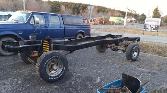

So after a LOT of deliberation, advise and research, I've decided I don't want to put twice as much $ as the Explorer is worth into a Skyjacker or James Duff lift, and skip putting a bracket lift on, so I bought a bargain rolling 1976 F150 chassis with HP Dana 44 and 9 inch with 4.56 gears.

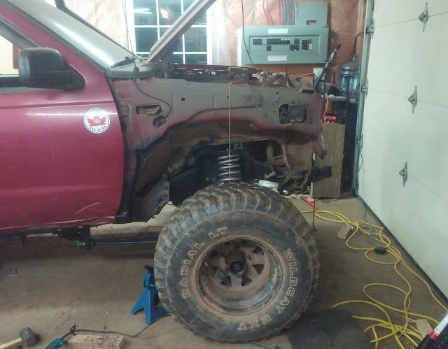

The 1976 setup is the same as my previously SASd 2002 Xterra, where I used a 1979 HP Dana 44 and full sized 8.8, and that worked really well.
The Xterra SAS wasn't perfect because the front part of the frame was a few inches narrower than the spring perches, so I'm hoping that's not going to be the case this time.

Same as your Xterra, the full width spring perches don’t line up with the narrower Explorer frame, but plenty of people have gone thru that issue, just browse through the SAS registry to see how others did it. PLENTY of knowledge in there, and the the corresponding build threads.
'76 would have welded on wedges on the front axle so it'd be super easy to cut them off and move them inboard. Spring issue solved. Why it has drum brakes, is odd, though. '76 should have come with front discs. Is it a high pinion, open knuckle axle?
Or you could narrow the housing. I used a '78/79 D44 for my Ranger SAS and narrowed the passenger side. A factory shaft fits the driver's side and the p/s is early Bronco width.
There are no BOM or codes in these axles.
The rear is stamped 73, and the front is HP drums and stamped 447F C35832
My guess is it's a 72/73 and not 76 as the seller told me. He said it was off a 76 F150, so maybe it was fitted with earlier axles from the factory.
I doesn't like theyve been messed with other than the chrome cover.
I really do like the idea of moving the Cs inward to match the Explorer coil towers to keep it as factory as possible.
In an ideal world I would narrow them, but that's beyond my skillset. Right now I'm looking for simplicity so I can get wheeling again once I've replaced the bushings, swapped to disks and replaced the broken shafts.
Just about impossible to say how it ended up like that. Probably is an earlier axle. Still totally usable, it's just kinda weird that they went through the trouble of putting 4.56's in it and not a disc brake conversion.
Narrowing the axle isn't too hard. You can chop the tube and sleeve it... that's the easiest way... but you need an alignment bar to keep the tube centered as it's welded back together.
