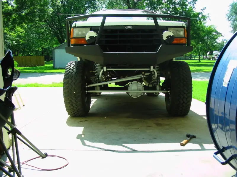

I found this pic. I know it's a solid axle, but I was wondering if I did this on my TTB if it would be better than stock?
I've put my truck on the alignment rack 4 times in two days. I've had trouble with the steering wheel being clocked. there is play in the setup but i have replaced the tie rods already. I think most of the play is in the gear box so I'm looking into that too. I'm thinking of keeping the stock tie rods, and making or sourcing a tie rod link, then have the pitman arm link attach to that. Instead of having like in the pic where the pitman link attaches to the right tie rod.
help or hurt? how 'bout it?
