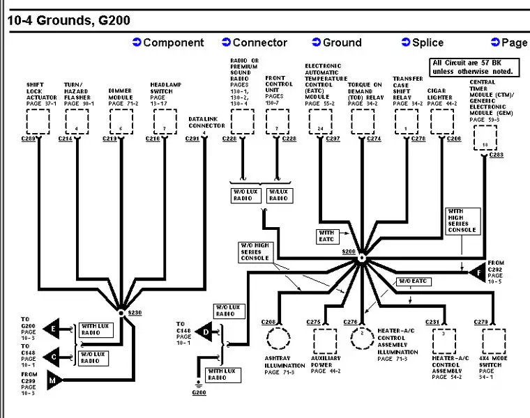

I have schematics at home - I will look at the two circuits to see if I can locate the ground points for you. Normally the ground wires will be solid black and they often lead to a fastener under the dash or somewhere on the body to complete the ground connection.
Sorry I didn't intend to be the king of empty promises....It looks like the radio and the GEM (controls power door locks) share the same ground G200 which is located somewhere near the passenger side kick panel.

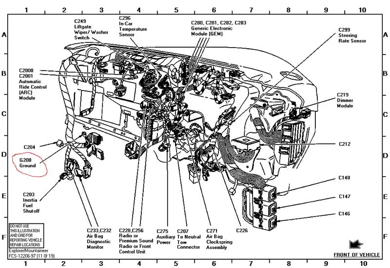

G200 picture
