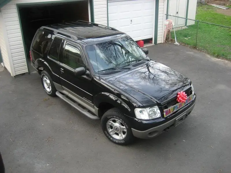

Help my exp. Shut off at 50mph and won't start back up. I am on the side of the highway. What could it be? It just cranks and cranks but doesn't start

Ok here it is I towed it to the Ford dealer and they chcked it out. They checked it out and told me the engine lost compression on the left side and 2 cylinders on the right side. So I decided to sell it for parts or a rebuild 2500 Hundred bucks. Let me know what you think..
That truck's in WAY too good of shape to part it...I'd do the rebuild.
