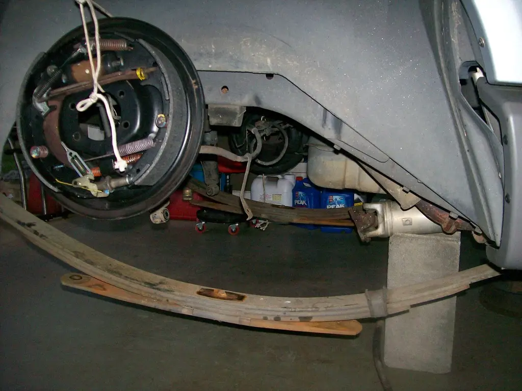

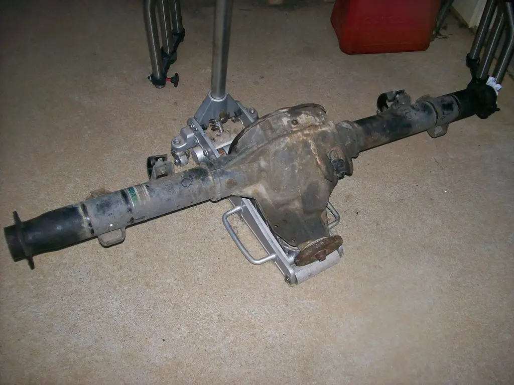

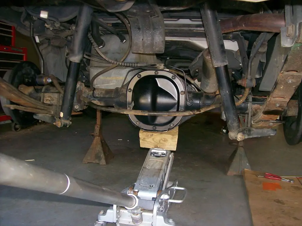

Any 4 door '95-'01 Explorer/Mountaineer (and maybe the 2 doors) rear diff with the same gear ratio is a direct bolt in. I installed one out of an '00 Explorer in my '01 ST. Only difference is that the Explorers had rear disc brakes where I believe the ST still had drums until '03. I just swapped the discs for my drums. I didn't even disconnect the brake lines during the swap. I just hung the backing plates up out of my way with close line.
Don't use a Ranger rear diff. They're only 28 spline.
