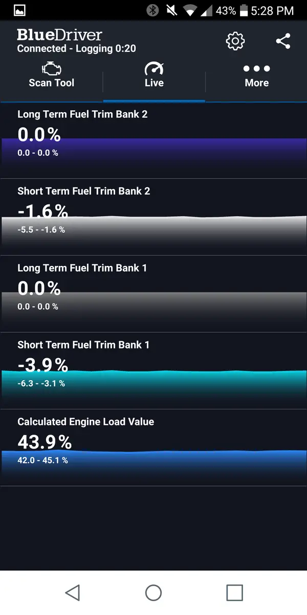

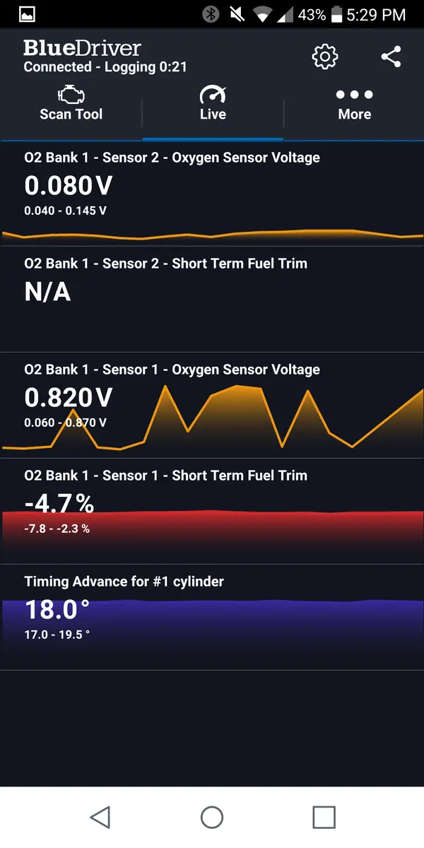

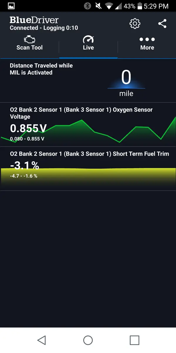

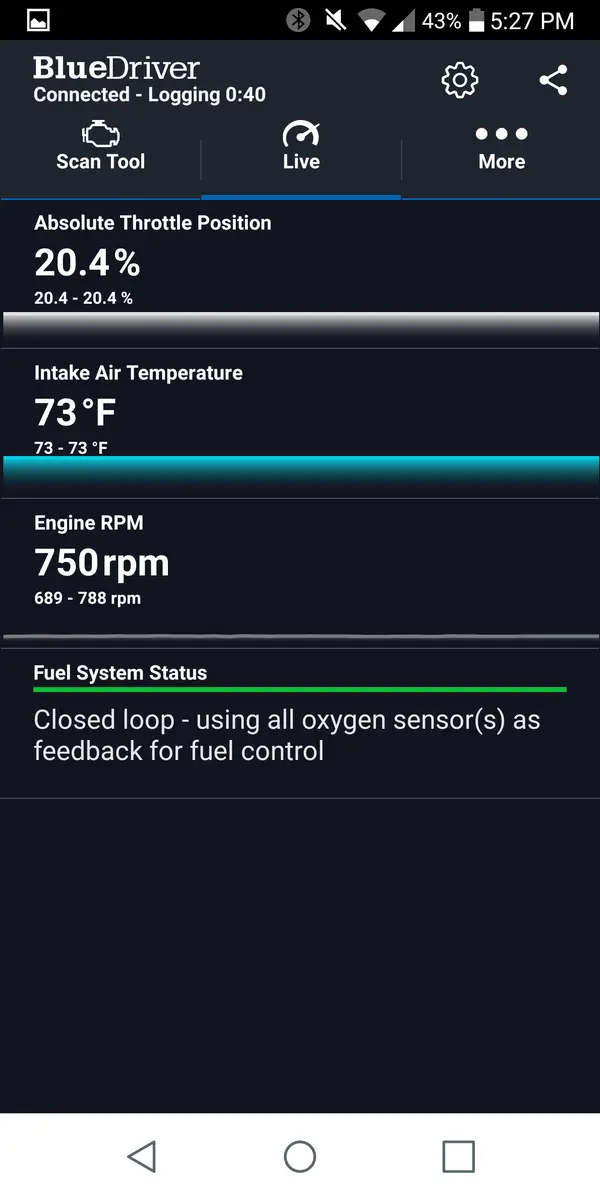

Ok I can do coolant temp, mass airflow rate, and any of these o2 sensors. Which of the o2 sensors do I need the data from? All?
Mass air flow rate is 1.1-1.2 lbs/ min
Coolant temp is 185
Edit: took screen shots of almost everything I have.

bank 1 sensor 1
Bank 2 sensor 1
Short and long term trims
I think you have a misfire
That's where I'd start
Posted everything I have. I can post mode 6 data if need be. Not sure what mode 6 is but there is some.
bank 1 sensor 2
Bank 2 sensor 1
