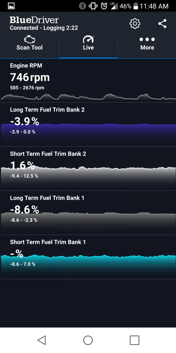

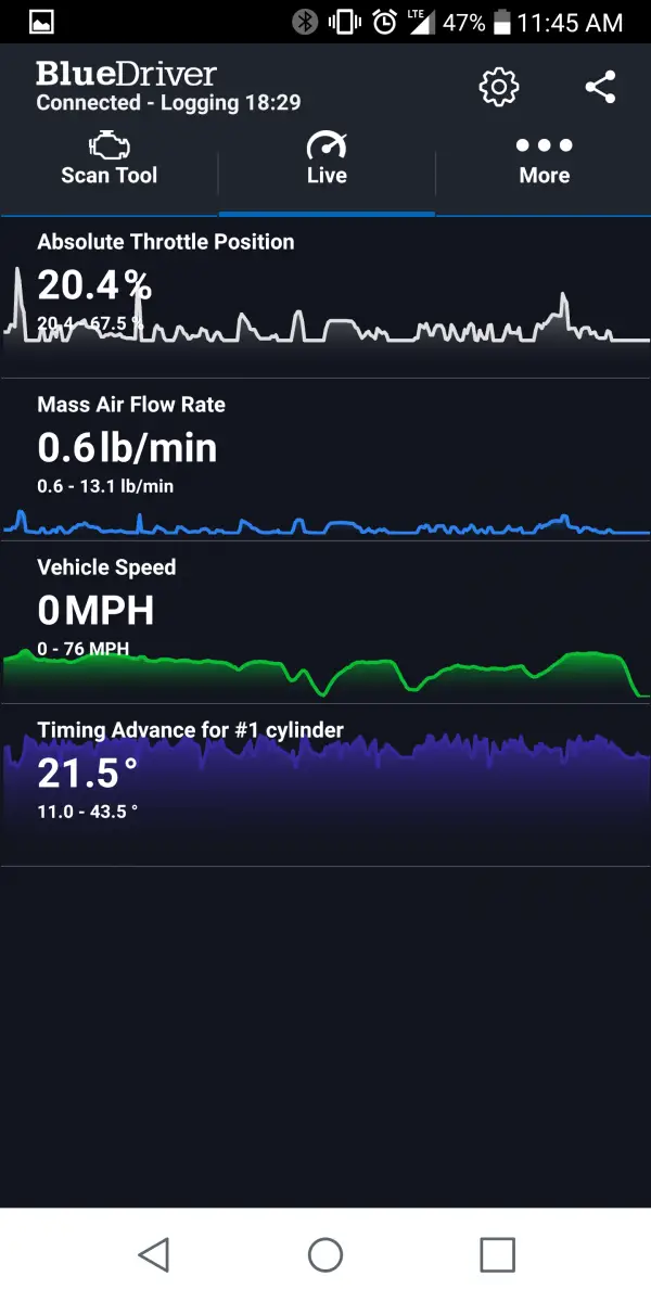

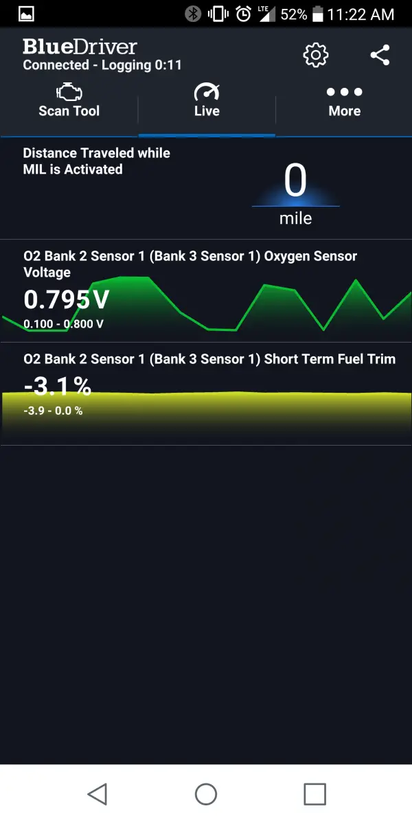

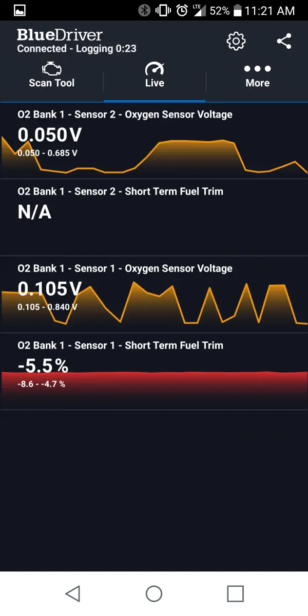

Feels like it's still missing a little bit. Drove it for about 40 minutes. Way more responsive but not "right".

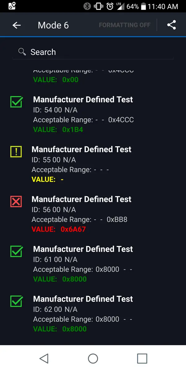

Well something is going on.
I cannot find out any good information on what this means.
55 was red with an X before but is now yellow. 56 has stayed red.
Something is up but I am not sure what.
What is that red test for exactly your truck may not support that test but other people's smarter than I will answer to

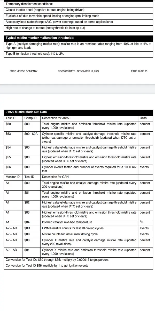

I found this but I don't understand it.
I'm not sure looks like a misfire events but not sure
This will be so much easier if you had forscan with a usb / Bluetooth adapter
Under$20 and forscan is free
It's definitely a misfire.
While I'm driving it never ever hesitates. While at idle in park and drive it misses. I can feel it.
Watching the live data on the scanner at idle at a light it's between 693 and 748.
I am going to swap the coil pack with a new one tomorrow. If it takes care of it I'll leave it alone if not I'll take it back and look elsewhere.
