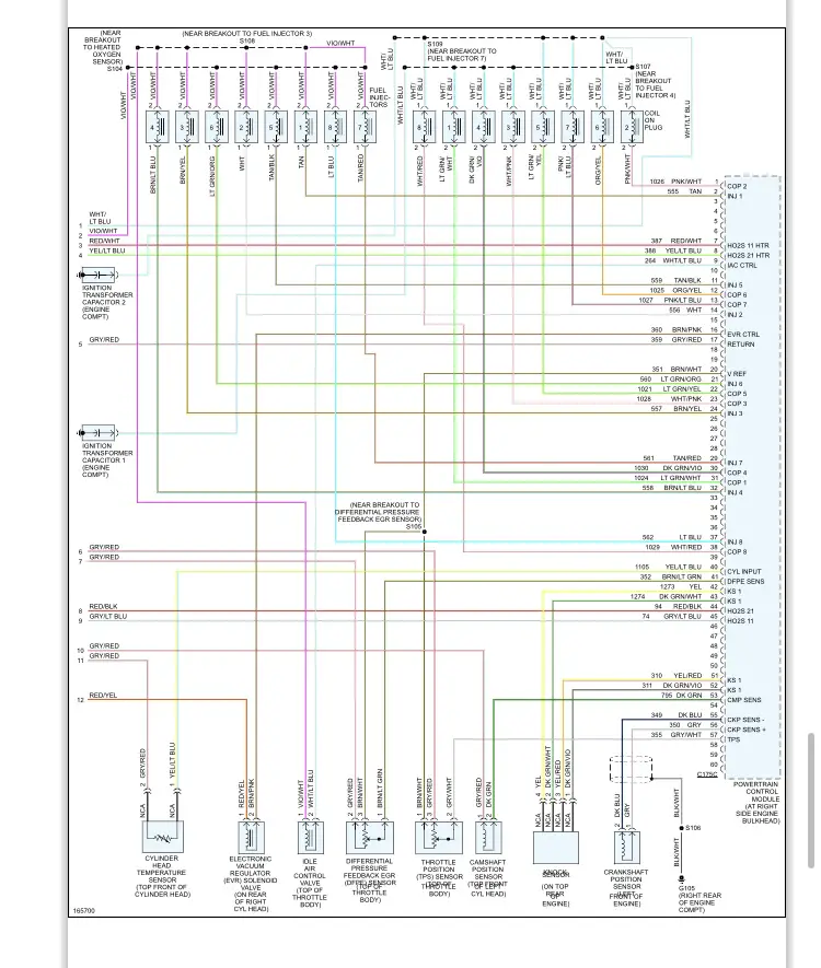

I also just looked at the wiring for the first time just now. The violet/white wire gets ignition power from fuse 39 under the hood, not the PCM. But the white/light blue wire is a negative variable trigger from the ecu.
I would unplug the Ecu plugs and unplug the iac plug. Then test the white/light blue wire at the iac plug and see what it reads. If should rear nothing. If it reads 12 volts negative then you have a problem. Use a meter to test. Report back.

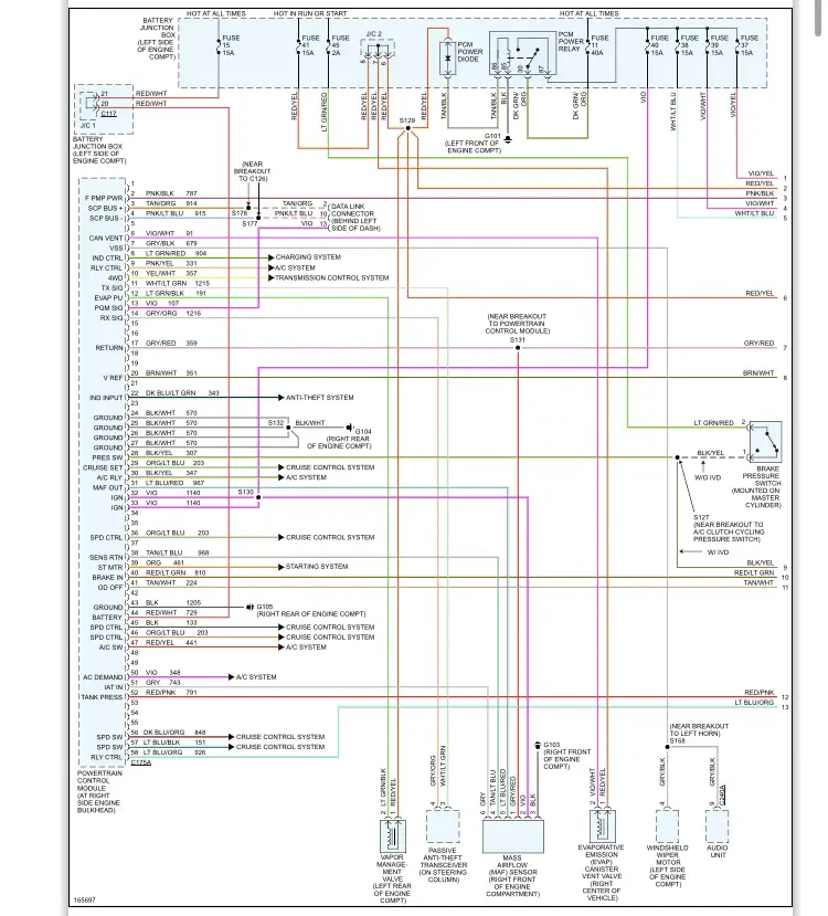

2 months ago I said it was a wire harness problem. And listed diagrams and how to diagnose it...
When there is “A Wire Harness” problem the dealer will only remove and replace. A good independent shop will find and fix the problem, without replacing the harness. You only have an issue with one or two wires. No need to remove the harness, that will just cause many more issues..
Call around, find a shop confident in this line of work and have them diag a fix it.

Problem Solved, heres the update and eventually the fix, tried running wires no change tried replacing the main engine and transmission harness and you guessed it no change still idles high. I began really studying the wiring diagrams and went sensor by sensor to all those affected and found the culprit after months of searching it turns out the cause of all my issues was a defective Ford DPFE sensor (previously diagnosed and replaced) that was internally shorted and caused all the other sensors to read high inputs so my high idle was actually caused because my temp sensor (on the same circuit) was reading -40 because the DPFE sensor intercepted and sent a erroneous signal to the ECU. So if there is anyone else out there with a 4.6 and you have a high idle and people keep telling you its the IAC (even though you have replaced it with a Ford one twice), do yourself a favor and take a ohm reading to your DPFE it just might be the cause. Thank you to all the input from this awesome forum it was all good info, especially GMCTYPHOON for the wiring diagram.
