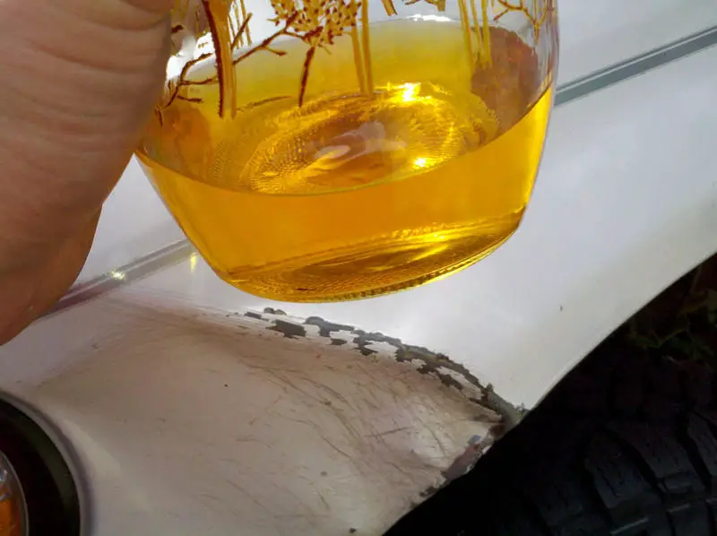

Definitely need some fresh fuel!
old fuel
If your fuel looks like this then you're wasting your time until you drain or pump it all out.
Anytime your vehicle is going to sit for more than 6 months you should add a bottle of fuel stabilizer to the tank.

The old fuel is on the bottom of the tank where the fuel pickup is. The new fuel will be on top of the old fuel. I suggest disconnecting the fuel line (maybe at the fuel filter), jumper the fuel pump relay and use the fuel pump to pump out all of the old fuel before adding new fuel.
So The old fuel will not mix with the new fuel? If it does not I can see it would be a problem. What about the fuel stabilizer/cleaner. That will not help?
