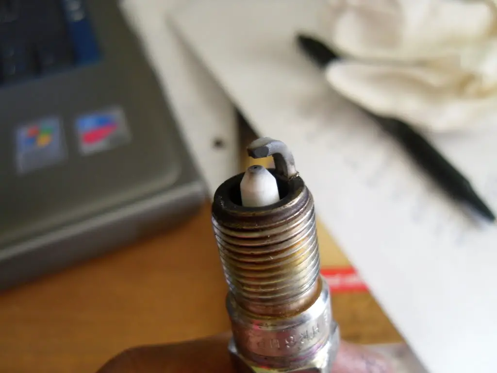

Welcome to this forum! I've moved your thread into the stock 2002-2005 section. Autolite plugs are the same as the Motorcraft plugs. Several people on this site have posted similar issues after using Bosch plugs. Could you post a picture of the defective plug? Was the gap out of spec?
Hi, ok thanks..really , didnt know there was a problem with these plugs.. Ive used them before in other vehicles and never had a problem until now...I wonder what kind of warraty Bosch gives on there plugs?? oh i will look into the autolite plugs..thanks jess
sorry unable to upload pic
OK, lets see if it works....defective Bosch plugs..dont buy this junk.!!!
sS.NMHC
thats what it looks like but thats the way these bosch platinums look..
