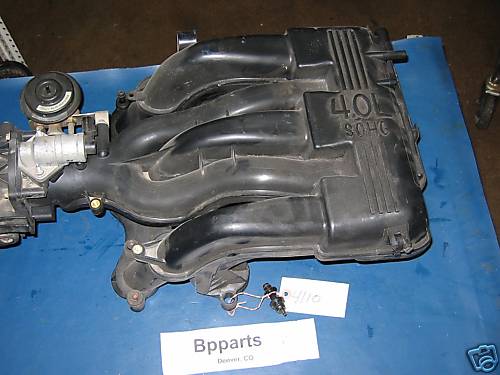

I'm not familiar with the 3rd generation intake configuration enough to determine what component you are referring to. Below is a photo of a 2004 intake manifold I found on the internet.
I suspect its the EGR valve which is round, black with a paper white label and a vacuum port on the top center in the photo. If so, then the vacuum diaphragm in the EGR valve is ruptured.
Is there any way to test the egr? I just bought it brand new out of the box. Mine also looks a little different (egr and manifold) I'd post pix but I don't know how.
