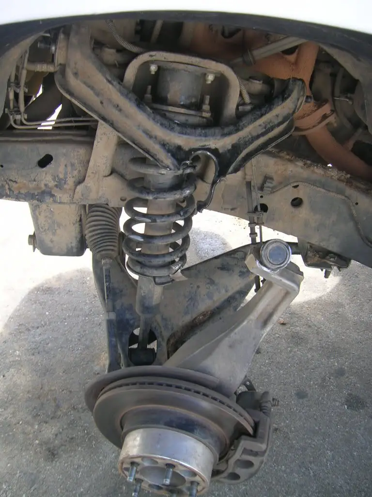

with 3 inch spacers you would be going through ball joints and CV joints very fast.
and heres a pic to of a 3 inch spacer and what can happen to your truck
offset is where your rims sit in relation to your rotors and fenders. if you look at the previous pictures of my truck, do you see how far my rims stick out? my offset is -6. your stock rims are +44. the lower the offset the further the rims stick out from the truck. when buying your 18's i'd reccommend getting anywhere from 0 to -6 offset so you have more clearence between your tire and steering knuckle
